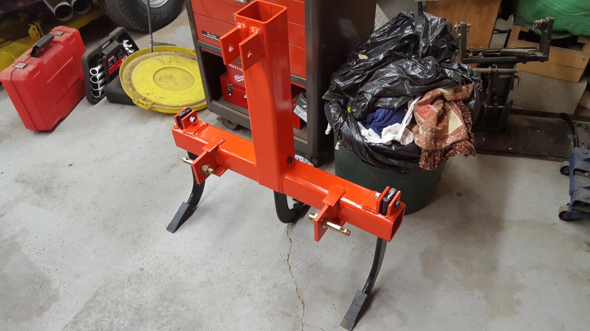

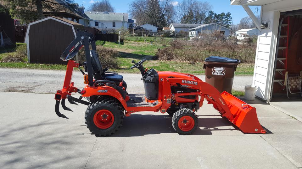

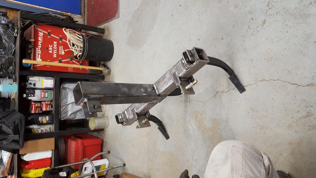

Nice job windzer! I see your in Illinois, I'm just south of Springfield, maybe I could have you make me one! I really like the 3 shank design!
I've thought about going with a subsoiler but these have 18" shanks and I would be able to use it for several other projects, where as a subsoiler isn't going that much deeper and I could always fab up a deep ripper shank and just use one shank.
windzer
Bx2370-1
Dec 8, 2015
82
Illinois usa
LOL small world I'm 15 miles south of Springfield myself yea I just used 18 inch box blade shanks for mine they worked out better than I thought I couldn't believed it pulled all 3 at full depth
