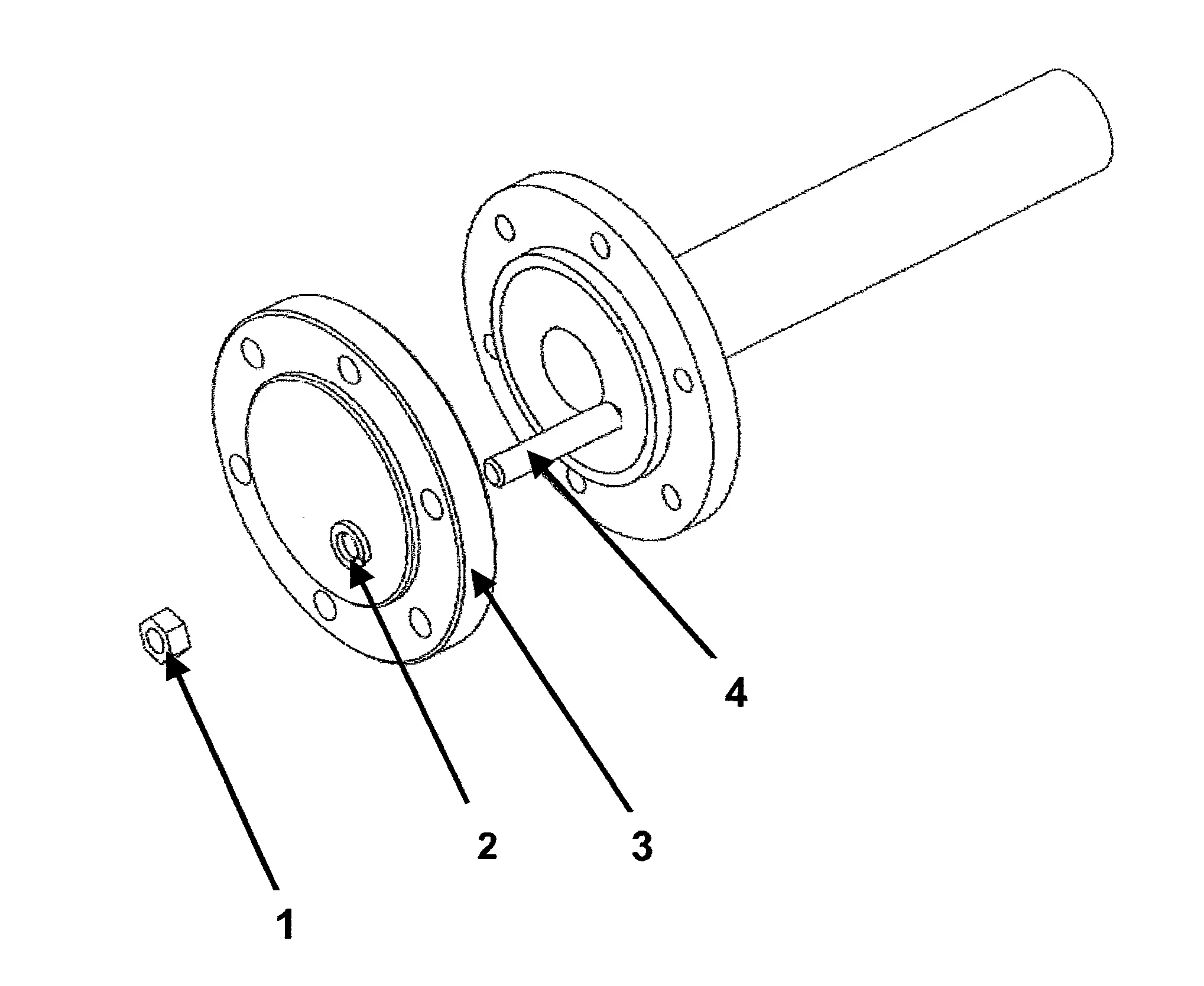

So just off the horn with Messick's..... they do have a kit (only 1 3/8") But better than nothing.
I hope to get a call back with the kit breakdown of the B8785 kit. And see if it comes with all the necessary options (there is a pin, lock washer, nut and spacer per side.
As a side note, he was sure to tell me Kubota frowns upon the aftermarkets for the above reason (top of thread) And no wonder, if they're only going 1 3/8..... I've seen 6" spacers!!! (total of 12" wider).
