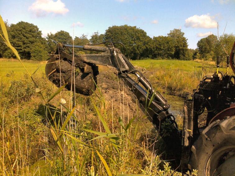

It sounded to me as a viable project. I converted a backhoe from a skid loader to the 3point on my MF35 and it is still OK after more than 10 years of work.
A am a doctor and not a technician or welder but I learned a lot doing the conversion and later repair work! :cool:
Nothing ventured, nothing gained.
