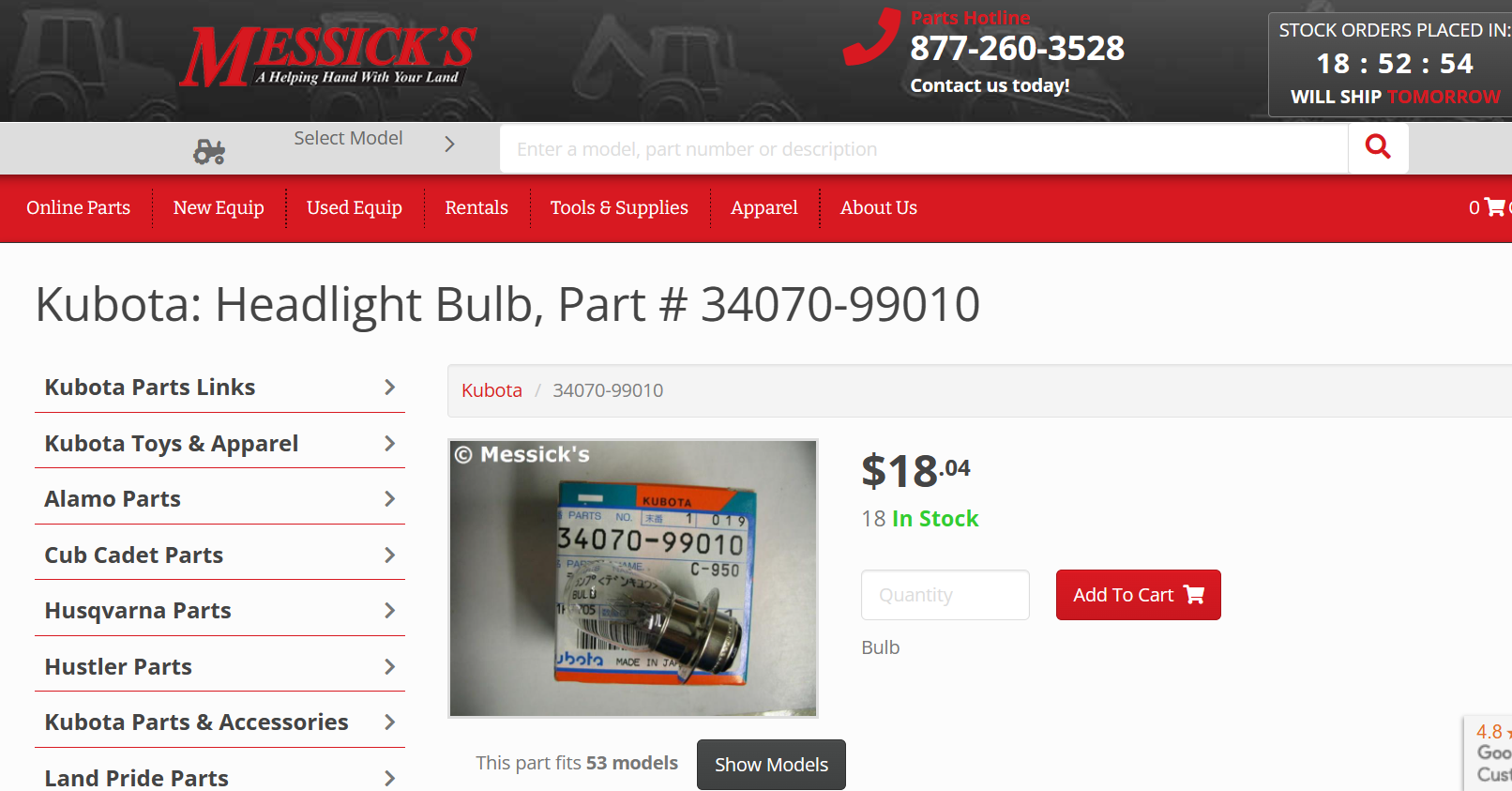

Parts diagram doesn't give much help. Neither does Messicks.
I'd be apt to take one out and take it to an Auto Store......see if you can find an LED match.

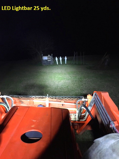

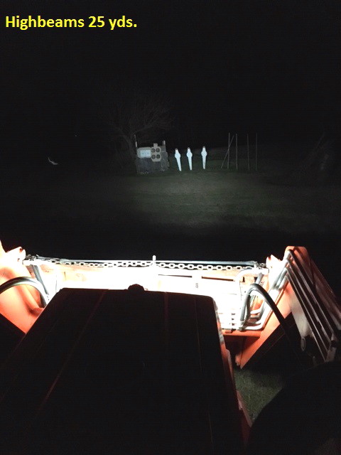

Even though the LED headlight bulbs were a great improvement over the OEM bulbs on my antiquated L2350DT, still not enough for any 'work'. So added an LED light bar to the ROPS.
