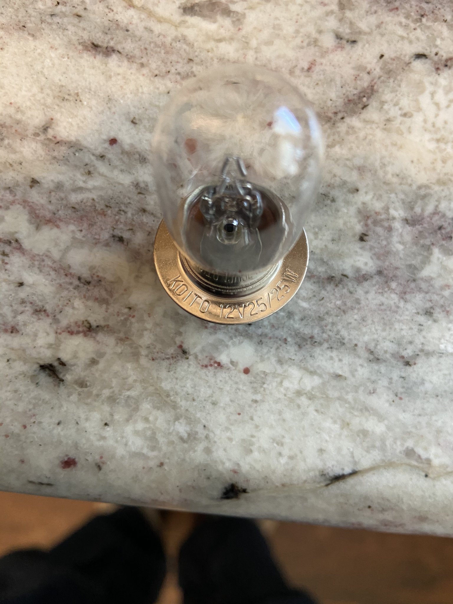

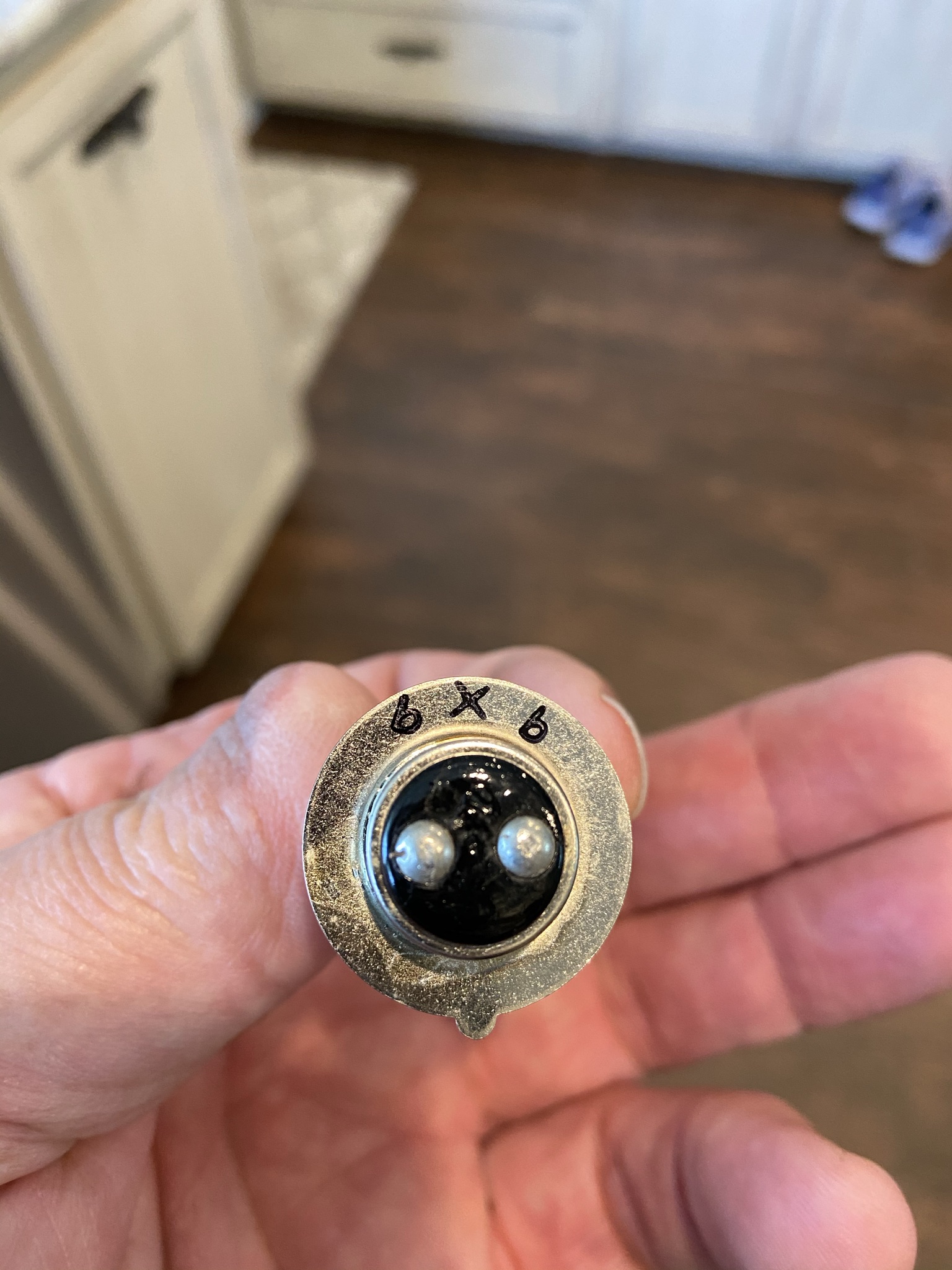

The tractor is a L3901DT. Thanks for all the great information. I have attached pictures of the current bulb.
Good luck with that one.. I have that in my Golfcart and can’t find the right length. It probably doesn’t matter as much for you with length. I found some for it but you could probably light a match and get more light. That’s been a hard one to find.
It appears to be a PX15 socket H6M base, if that is the case, it is not a current automotive type bulb.
