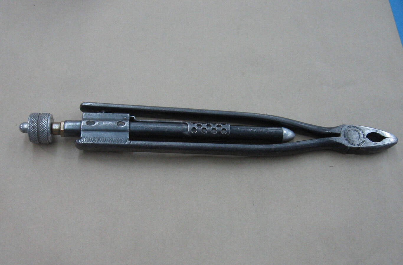

There is some clip that holds the rubber cover to the joint. I think it is probably a small diameter wire that is three or four wraps. I have never seen the proper way to remove or install them but they are generally a pain to get removed and installed. I have damaged that type of clip getting them off so suggest you get new ones. You will need some sort of tool to get them off and then on. I use a pick or pointed blade that is not sharp.

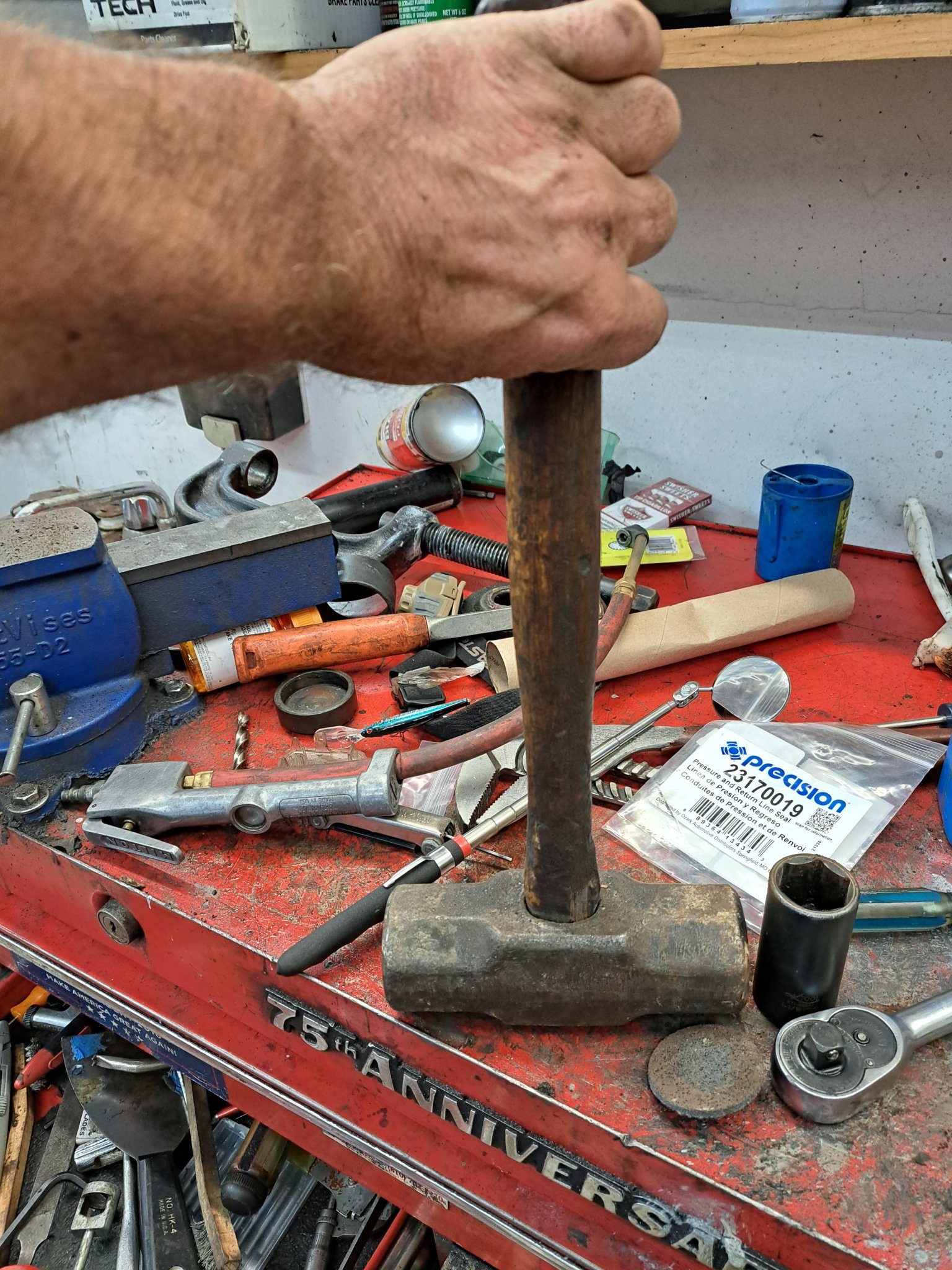

I am going to be the dissenting opinion here.
I have done literally "thousands" of ball joints and tie rod ends.
I have only used a "pickle fork" once ....ever......and I do not suggest you use one.
Just use a BFH to "hit that SOB as hard as you can" on the knuckle.
It will drop out just that easy.
(just don't miss....that BFH will do serious damage to fingers/knuckles and such)
If you use that "pickle fork" be sure to have a spare end, cause your gonna need it.
Today I am working on a "clapped out" trailblazer and I just dropped the ball joints, and both tie rod ends and i do not own a "Pickle fork".
Here is my BFH.
Here is the ball joint I just dropped.
Note: No damage to the boot or joint.

We are in agreement, my brother. The balls on my current Kubota have a turned down thread at the ends. The threads are machined off and the end of the bolt is narrowed so it won't mushroom out and damage the threads when using the BFH. There's a certain satisfaction when separating a rusty ball. Thx for picture. That said, it isn't necessary to separate the balljoint on the B or BX tractors to replace the inner tie rod boot. Just unscrew the tie rod end from the tie rod itself and toe the wheels out. If replacing the ball joint itself, we like our BFH.
