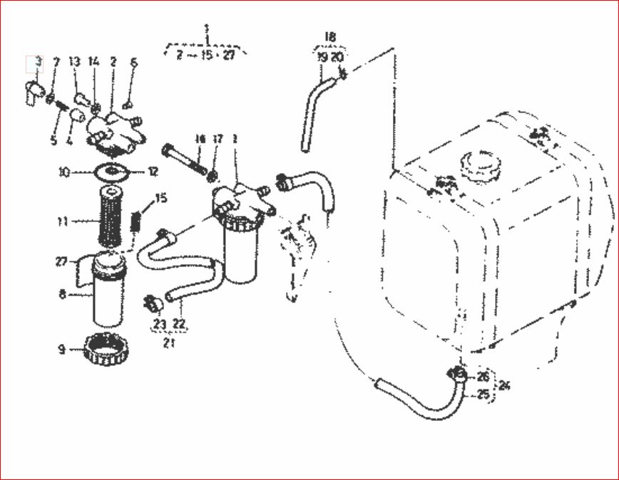

B1600???? :confused: (see edit below picture)
Did you mean 6100?
If you did, that's a very simple fuel system, if the tank is not free flowing fuel out of it, then the fuel line is bad or the tank is plugged, full the tank and clean and while you have it out replace the fuel line.
If fuel flows good from tank then pull the filter assembly off and remove the valves and vents from the housing and clean all ports.
Here is what your looking at.
EDIT: Sorry it could be a B1600, that is a Grey/gray market tractor and you can post a few photos of the fuel filter setup and I might be able to find a cross it over and figure what might be in it.
Did you mean 6100?
Hi there, what is the Number 26 on the picture called? is it a fuel tank valve?
cheers, seb
