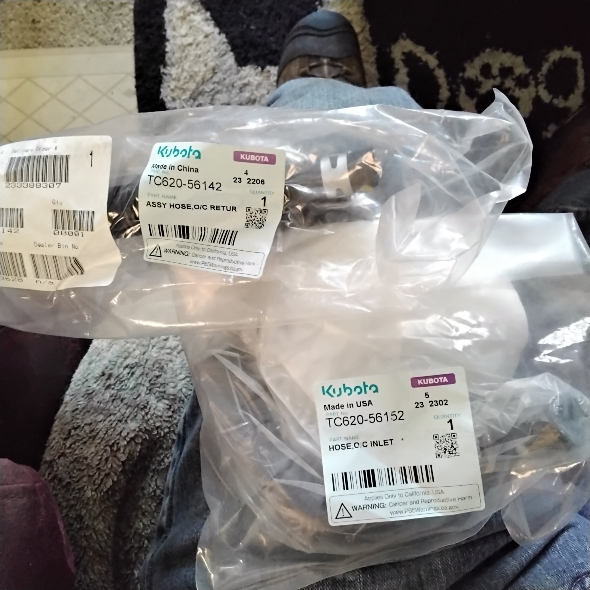

Did it work? Trying to post photo of Kubota Oil Cooler hoses for L 3901 HST

Looking at the 2 that I got they are specially formed, both Inlet and Return hoses,and the Return has different diameters at both ends. I turn 66 today and retired today and this hose job is happening tomorrow. Glad I bought 2 sets.

Done! 3 days,not all on the tractor
Best advice, Harbor Freight Hose Pliers, 11,99 for 3 sizes,absolutely would have been unable to slide hoses up on the 2 inlet,2 outlet fittings on the cooler and engine fittings. The reason for this is the hose clamps were done so tight they distorted the ends of the fittings,sloppy work from factory, tightened them so much that rubber from hose squished up between the slots that the screw uses to tighten the clamp with.
Something that anyone with this feature on an HST tractor should inspect. I am of the opinion that overtightening these hose clamps directly contributed to the hose failure on the the lower short hose. This hose is only 6 inch long with 3 preformed bends in it. The cracks on both ends of the hose were inside the hose clamps.
