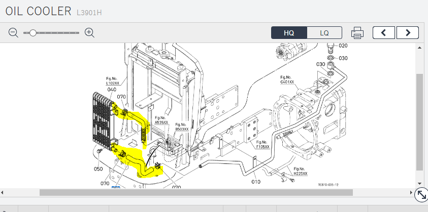

Anyone ever done this. Every 2 yrs replace per Operations Manual. Mine is leaking ,can see it underneath from tractor while running. Looks like more than I can deal with. If anyone has or knows about doing this job on 2015 L3901, I would really be interested in learning. If it's a dealer job would like to hear about this also.

I read replace every 4 years?
Where is it leaking?
Is it leaking at the hoses clamps on the front of the radiator, or somewhere else?

Thanks to all who replied. From what I can see,the upper clamps are the spring clip type,the only lower I can see has a hose clamp on it,it is the one that is cracked and leaking,the illustration clears a lot for me, will have to look tomorrow again at the front radiator/oil coolers,there are 2 of them. Would love to be able to fix this myself. SIS, (self inflicted stupidity) in not having WSM for my tractor.
Who should I buy WSM from,?. Tractor in stall in shed need to get it outside for operating room..
For sure will be replacing these hoses and making spare set, look preformed but if I can make straight hose work? Thanks again to all who replied and welcome any and all input on this operation.

Just reread the Owners manual,check every 200 hrs,replace every 2 years,note in row 14, on page 56,
Last column,the number 4, go to page 86 to see note 4 says," Replacing Oil Cooler-Line ( HST Type)
Consult your local Kubota dealer for this service" . Should a read the fine print.!!!
What you guys say to me ordering these lines from Messicks,if available,and see what it looks like when the 2 lines get here. If I can't make it happen ,send it on to my local Kubota dealer?
And life is all about knowing your limitations, and when to exceed your limitations. Not sure on this.
Thanks again to all who replied.

Maybe just tightening 4 hose clamps would provide a fix?
Mine were leaking at the oil cooler when I first got the tractor (new). Fifteen minutes with a screwdriver stopped the leak. The cooler end is easy to access with the battety out - not sure about the other ends but I dont think replacing them is going to be a difficult task. I would certainly use new preformed hoses.

Many thanks to those who sent WSM,and to those who replied. Calling Messicks tomorrow to see if I can get 2 sets of hoses, 1 set for spare parts as this could be an issue in another few years, hate to need them later only to discover they are discontinued.

WSM organization is a bit strange. You will probably find the oil cooler and lines in the hydraulics section. I also suspect you wont find step by step instructions on replacing any hoses or pipes. Left as an exercise for the reader.

The PDF manual has an index/TOC hierarchically organized by component/theory of operation (mechanism)/ service procedures in the left pane of the reader. It will get you close.
As far as I can tell there is nothing specific in the L3901 manual on how to replace the oil cooler hoses. It simply identifies their location and assumes the person doing the work is experienced enough to figure out how to remove them. It ain't rocket science or brain surgery.

Also shown on Messick's parts pages under "hydraulics"

Smart phone dumb and computer illiterate, but have managed to find on page 571 procedure for getting started on replacing hoses. Tablet doesn't work like computer,on search it gave 70 references to "oil line cooler",but highlighted the text when you flipped past pages. But I found a good start to this project.
HUGE THANKS to all who have helped me on this project. Couldn't have gotten this far without the help. If I can get parts I will attempt this. Thanks again to all who replied.
