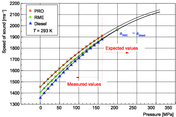

The internet can be a wonderful thing and I think this answers the question:
The fuel injection pressure waves moves in the injection tubes at speed of sound in diesel fuel. This is a finite number so all tubes must be of tuned(same) length to ensure no effect on fuel injection timing.
It is the arrival of the pressure wave not the fuel itself that controls the timing. Using the graph below we can see that the speed of sound in diesel varies with pressure but let's call it 1500m/sec.
Speed-of-sound-for-tested-fuels-experimental-values-from-atmospheric-to-160-MPa-pressure.png
Using that value the arithmetic is pretty simple if you have a calculator - a one inch change in length alters timing by .000017 seconds = .017ms.

Good work Henro you got me all geeked up. :unsure:
Interesting! Thanks Dan.
So I guess my follow up question would be: Is 17 millionths of a second for a 1 inch difference significant?

Above my pay grade. I would think that's noise given the other variables inherent oin old style pumps.

Once I get geeked its hard to stop.
Just doing a little more arithmetc:
A diesel crankshaft running 2000 RPM sweeps 2000/60 x 360 = 12000 degrees per second.
A .000017 second delta in start of ignition = ..000017 x 12000 = .204 crankshaft degrees.
Ponder that.
