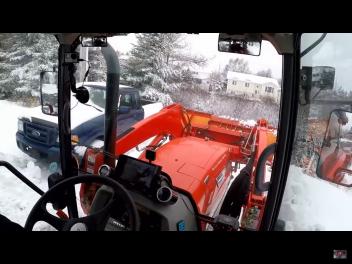

Lots of guys with Cabs have done them, While I would like a cab, I think the view is somewhat less than without. If you do a You Tube search for paul short, he has several mounted in his Grand L and they do a very nice job. If you go that route post some pictures, it might give someone else some ideas

Not sure about the sissy part but here you go. :D
