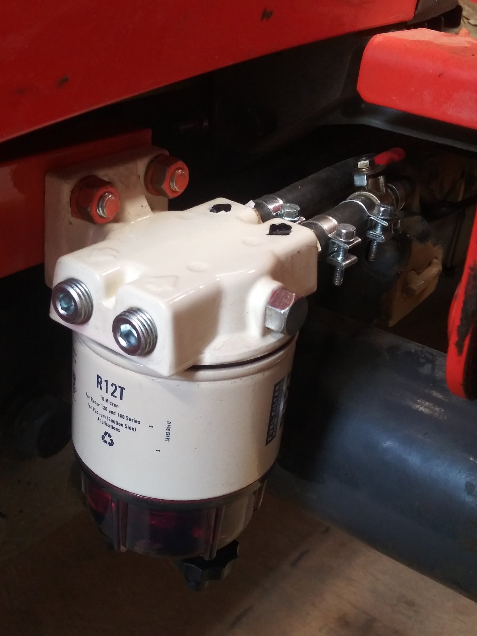

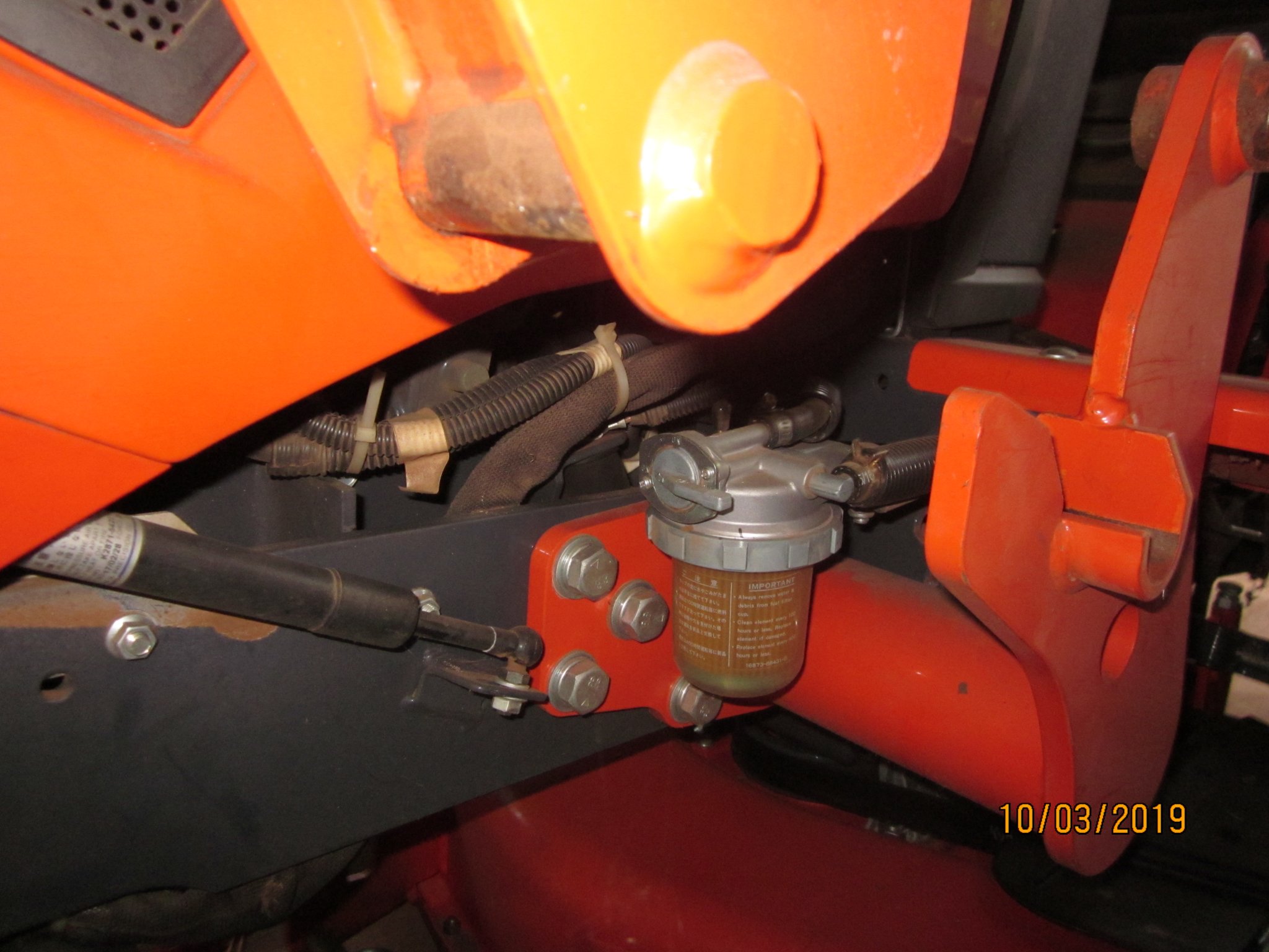

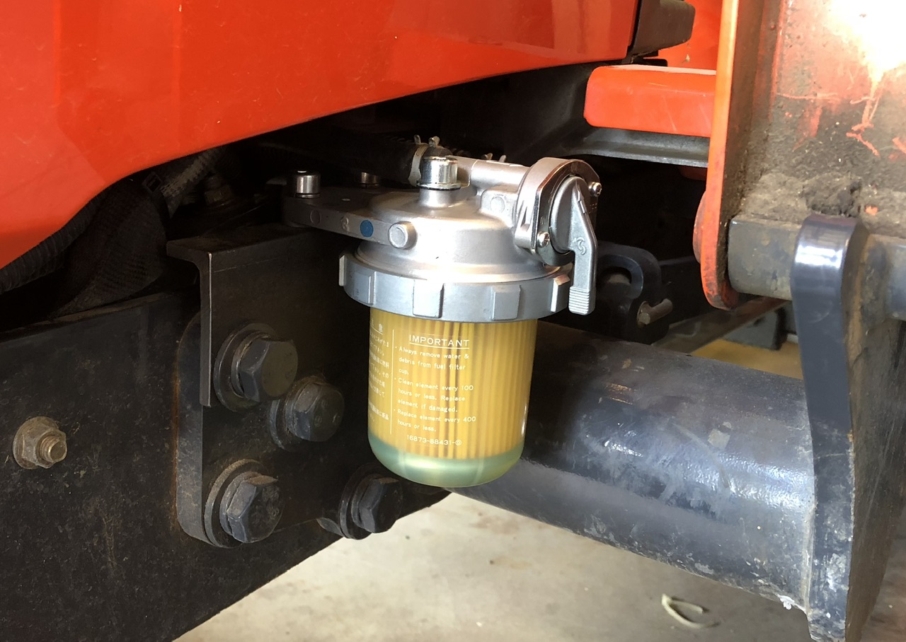

IT has been done a lot - here is my example:

The only thing I see that needs to be done when relocating the filter, which I think the big "K" should have done to begin with, is a guard over the filter. If your luck runs like mine,, yup ,,,you are going to find something some place to jam in it
Yep. (y)
That's what has held up my conversion. I need to make a guard. I've been working out in my head how to fabricate something that looks decent, using limited metal-working tools.

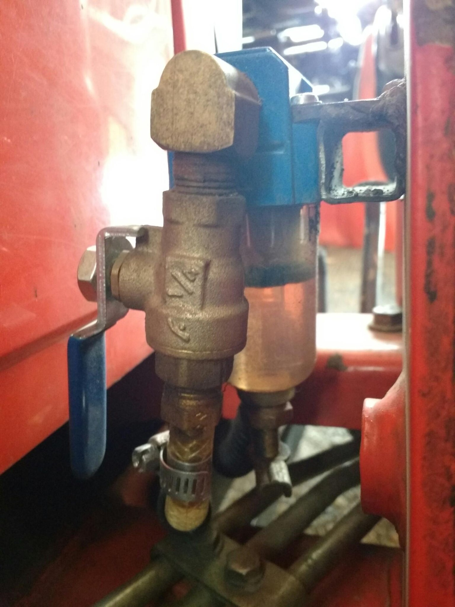

Where did you get the kit for that?
Or did you part it up yourself?
Jim,
Bought all the components separately. 5/16" hose - like 10', good hose clamps, and maybe the most important piece - the 1/4 turn ball valve. And of course the filter itself. Making the bracket took a bit of cardboard and trial and error. I am with Skeets - it does need a undercarriage to help with smacking that one stick that will FUBAR the works.
