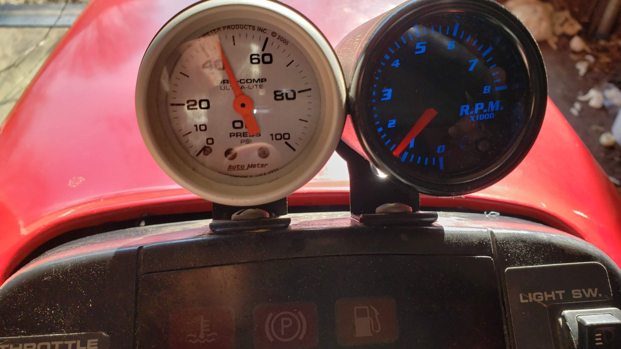

I would like it so I can get repeatable results when applying material to my lawn. I put a tach on my old Honda 4514. (along with an oil pressure gauge which I already have for the Kubota now). I was able to set the pressure and volume on my tow behind sprayer for perfect yield by knowing if I set RPM to (IIRC 2200) and set the hydro lever to full mowing speed, I would get the proper yield from my tank.
Now I have to guess at it. I guess instead of a tach I could get a cheap GPS speedometer, and then engine speed would not matter.

Well while I don't care about "actual speed" as all that matters is being able to get a setting dialed in on the sprayer, at whatever RPM/Hydro setting I like and then being able to duplicate that. So, RPM or a speed reading of some kind would work. I just think I'd like a tach better as that along with a true temp gauge and oil pressure gauge and I'll feel better about my orange baby
