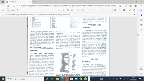

"The block of your 7100's engine is equipped with wet sleeves, that can be pressed out and replaced ad infinitum. "
The B7100's motor uses dry sleeves. They're thin wall sleeves that must be bored straight again after being pressed into their parent bores in the block. Unlike dry sleeves they tend to warp when installed. They have enough meat for them to be bored out once, hence the oversize pistons and rings, other than that the sleeves are replaced.
Hi,
I am contemplating re-sleeving a D750. I read somewhere that they are semifinished. From a workshop manual that I have there is no mention of the need to further machine them once installed. I am confused a bit.
32,681
8,210
Hi,
All sleeves for these are semi finished, the outside bore is right it's the inside that will need to be bored to the finished size after they are installed in the block.
That is not a DYI thing
You need a good machine shop or engine rebuilder to do that.
One option is to get oversized pistons and bore the existing sleeves for those pistons.
