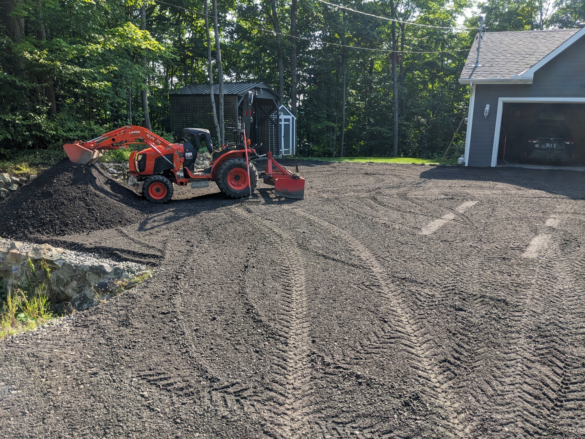

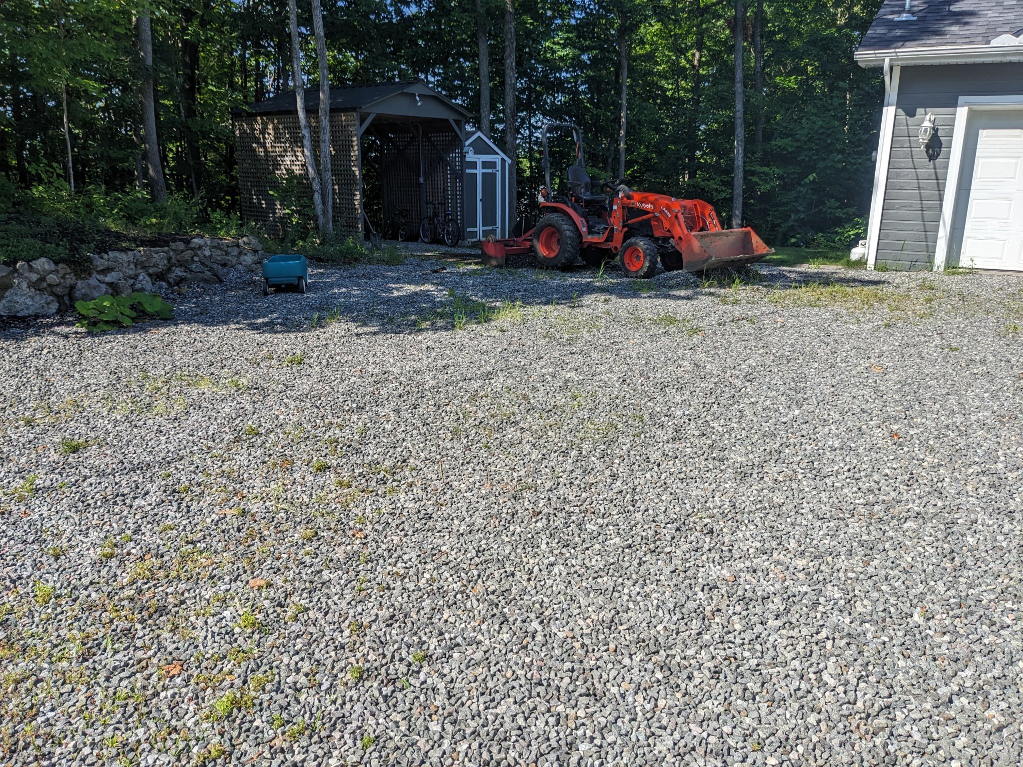

New project starting today
I was tired of blowing gravel all over the place in winter so i'm going with recycled asphalt.
I borrowed a box scraper from a guy nearby. It's my first time using one of those.
The plan is to scrape it all, move it in a pile in the backyard. Then I'll get about 36tons (2 x 12 wheelers) of recycled asphalt.
The gravel looks way nicer and is very effective at draining water so I'm kinda bumed out that it's just not workable in the winter.
I'll have to grade everything perfectly so water doesn't pool (non issue with gravel) and I hope it's not gonna be as messy as stone dust on the front door inside carpet.

Doesn’t look like you have a surplus/thick layer of stone.
I’d be apt to put scarifiers down on the borrowed box blade and churn/blend your existing stone a little. I wouldn’t peel it off.
Then regrade everything with box blade with scarifiers up.
Then I’d put grindings/millings down, regrade rough, then tamp with plate compactor.
Just my suggestion. I think compaction might be important. Otherwise, you’re going to throw asphalt instead of stone.

I am planning on rolling it. There's a rental shop close by and they have those big rollers just for that. Not sure how that costs yet
And I do have a good amount of left-over gravel. I have another project for it. I made 2 piles: 1 for clean gravel and the other one that's just crap.
The box blade is awesome. I like this thing already.

Another successful project completed.
3 loads was too much.
But I had another place I decided to "pave" so no leftovers except for that small pile that I'm gonna use for touch-ups.
Now I have to get a roller. Next month ...

Nice work so far! Did you do more back dragging to spread, or box spread?
Only box.
I have a hydraulic top-link so it's even easier. I went from the street to the garage with the box tilted down, to scrape. Then the final pass was from the garage to the street tilted up. This way, I have a good slope. I have a laser to check the grade, so I'll double check with that.
I won't bother too much with low points right now. The roller, and a winter will do its work. I'll touch-up wherever I see puddles forming.

How did this come out? I have to redo the driveway this week or next after having it dug up a bunch installing the conduit for solar, graded out the dirt they dug out and even "compacting" the trench with the weight of the tractor and filled tires......need to probably get at least 1-2 trucks of RAP if I can.

I'm not too good at grading things so there are a few bumps. Winter will sort everything out. Next year I'll do a few touch ups
