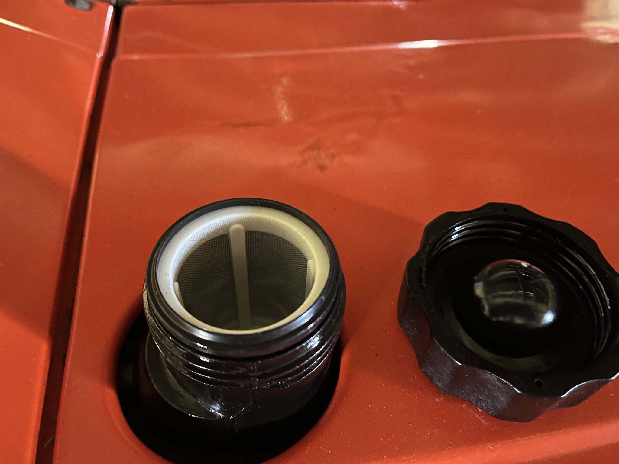

This may work for you.
Fits KUBOTA Tractor models:
L225 L295 L245 L1500 L1501 L1801 L1802
L2000 L2002 L2200 L2201 L2202 L2402 L2600 L3001 L3202 L4202
SPECIFICATIONS:
Top OD = 2"
Screen O.D. = 1-5/8"
Overall Length = 2-5/8"

Thank you ! I will make more precise measurements and figure out the ID of the step down in diameter of the filler neck but this one looks like it may work! I will update the thread either way.

Thanks again D2…. Perfect fit👍👍
