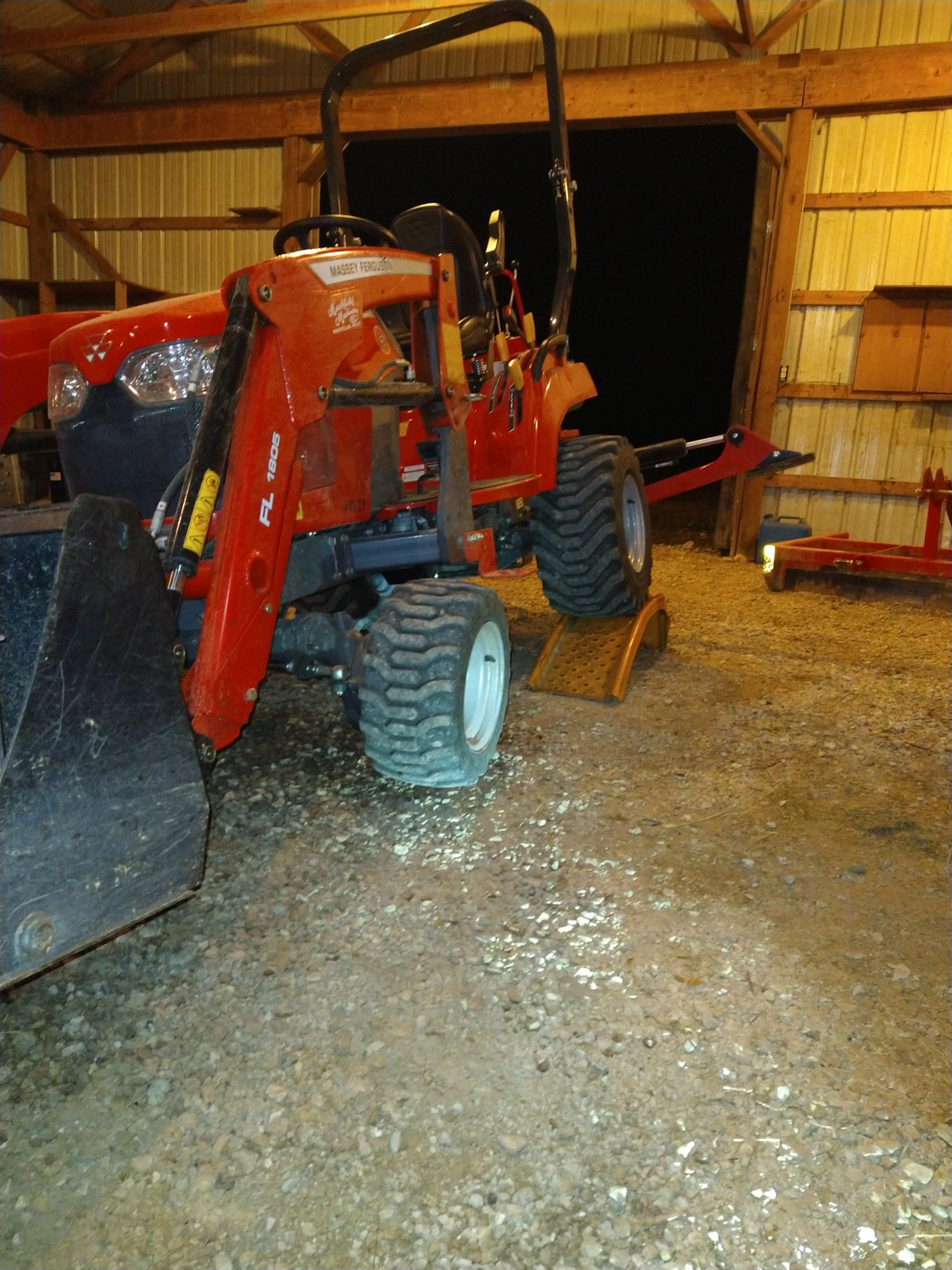

Henro, I fully agree that front spacers do not allow any extra stability on a side hill, UNTIL the axle meets the frame stop ... But rear spacers provided additional stability all the time.
In my experimenting on my MF that happens at approximately 4" on either the front or the rear .. 8" rise on the rear lifted the front tire on that side a tad over 2" in the air! But tractor was stable at that time, I could climb on and off, and "shake it" with my 200 Lb body ... I used my BH to "catch it" if it went over, but it was not necessary! I feel the front spacer did add to the stability in that case ...

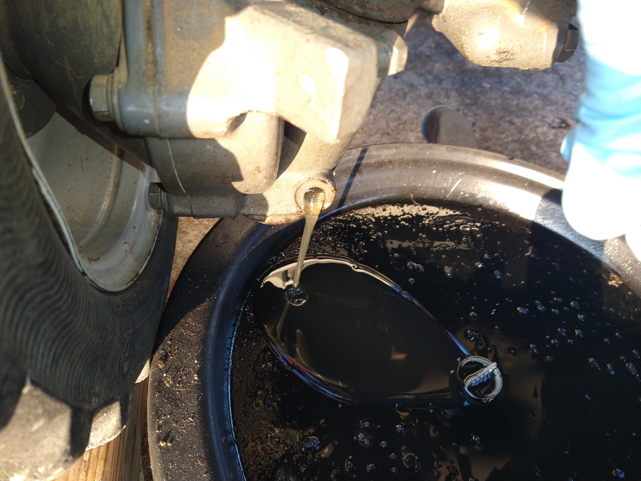

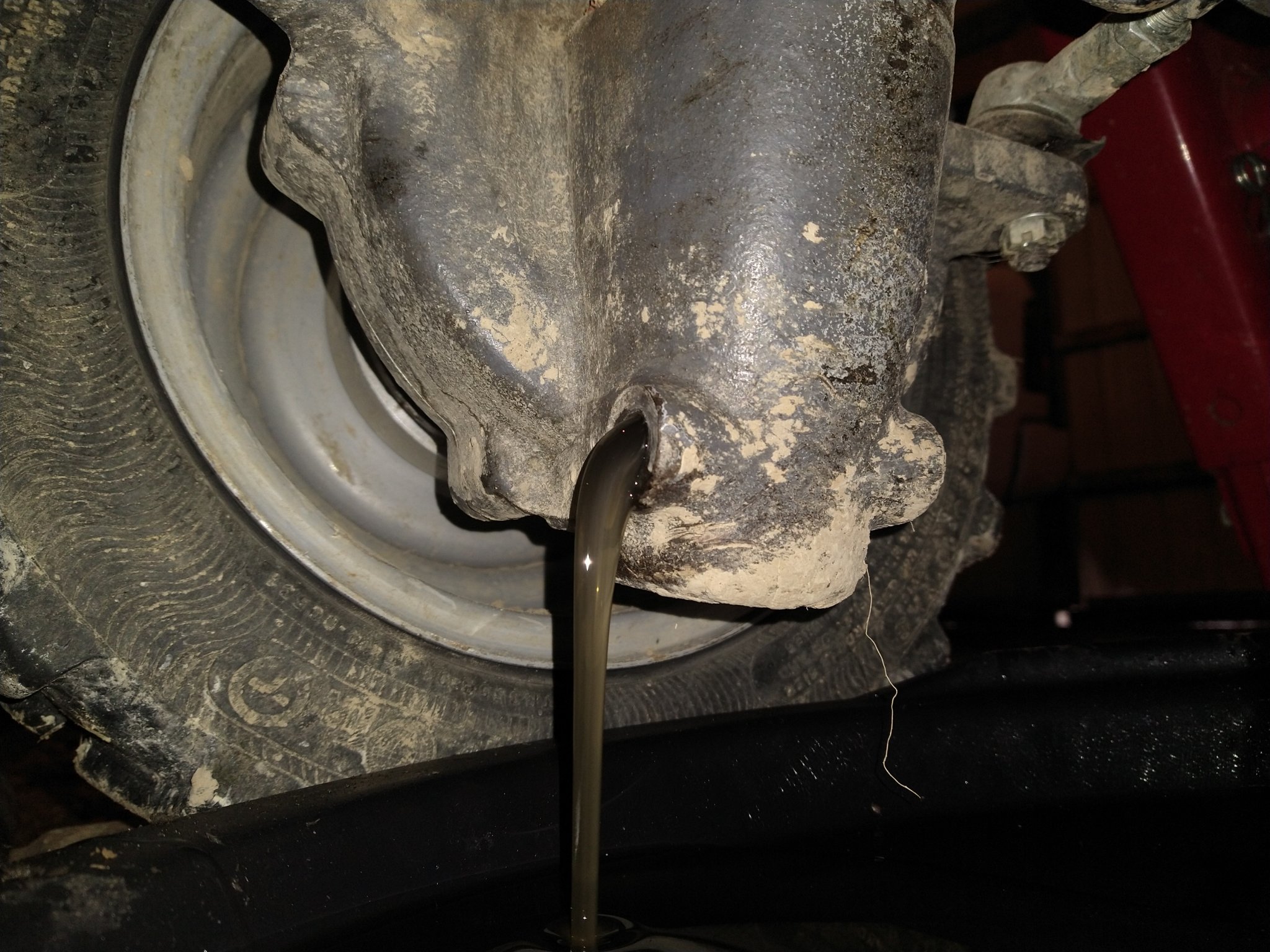

The other cause I believe of premature front axle bearing wear/breakage is the lubricating oil is not changed frequent enough ... There is no filtration system, and with the additional stress of both spacers and not enough ballast they take a beating, and are swimming in abrasive fluid ...
This is my MF GC 1725 MB's front axle fluid (hydraulic fluid) at 244 hours from new . . .
90 hours later ...
I now aim at 100 hour change intervals . . . Even though Massey Ferguson "recommends" changing the fluid every 500 hours, or two years ... I have slightly less than 600 hours now, and fluid has been changed 4 times, tractor is less than 3 years old, almost due for another change.
Fluid is cheap, rear ballast also keeps the tractor stable . . .
