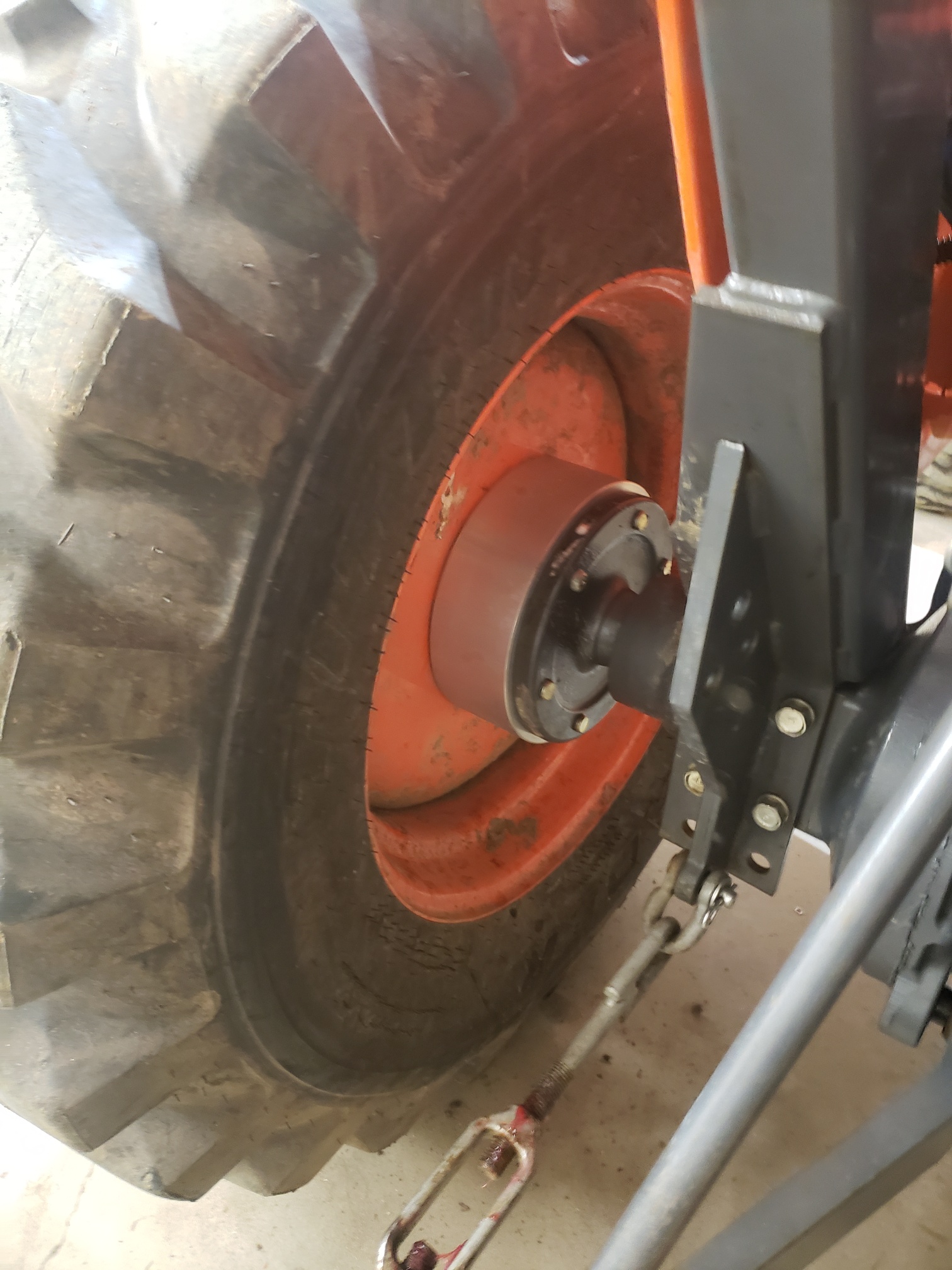

Went with 3" Bro-Tek for our LX2610. It already had kubota dealer installed 1 1/2" spacers but I picked up some gargantuan Trygg ladder style snow chains. The inside shackles came too close to the hydraulic lines on the outside of the right frame area. I will let you all know how it turns out when I get them installed. Bro-Tek assumes that you don't have spacers already so their instructions are close but don't work because you are short four of the tapered head stud bolts. Looking forward to getting it done.

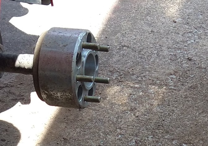

I installed these over 5 years ago.
No problems.... bolted right up.
At the time they were $33.00 they are now $52.00
Billet alum. 6061? not sure....
But I would bet a dime to a dozen donuts that they are the same as the high dollar units.
All I know is it sure beats paying $250.00 or more for the name Brotek
My $0.02
6,016
3,253
My $0.02

So BroTek 3" spacers installed on the rear. My Trygg modified snow chains on the rear have now plenty of room to do their job without the possibility of any damage to the frame and cab area underneath. Glad I did the research and got this done. Used the box snow pusher yesterday and all is good.
