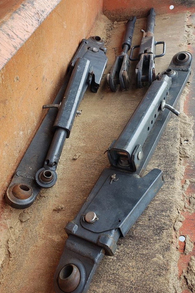

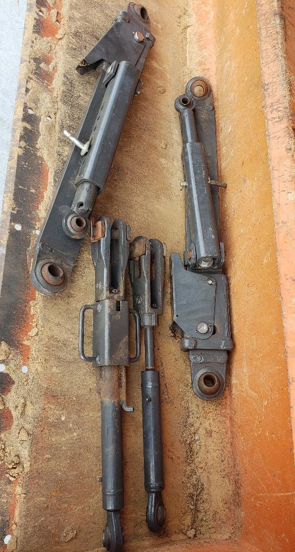

Looks like a man can not get telescoping arms and adjustable links for a MX4700 tractor ! Talked to two dealers , and like everyone else , their parts guys are either new and can't help me or dumber than a box of rocks and don't know what I'm talking about .
My 2012 MX4700 came with NON telescoping adjustable 3 point hitch arms and a turn buckle type adjustment links .
I bought what I thought I needed from another guy on here and they are too big for my tractor . Looks as If they may came off a 7040 or maybe a 7060 .
I attached a pic of what I bought . I listed them on eBay If anyone might be interested . Or I'd sell you them here and ship to you .

Those are for a larger M series like an 8540-60 and a 9540-9960.
The slot & guides on the side links is the for sure give away. :)
