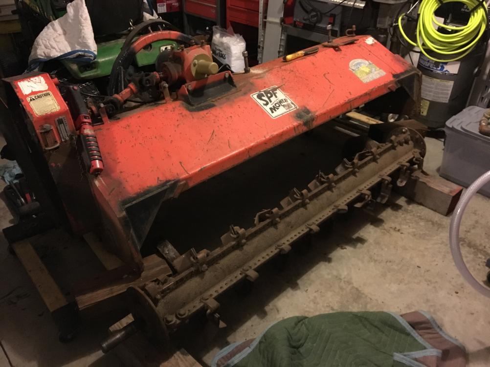

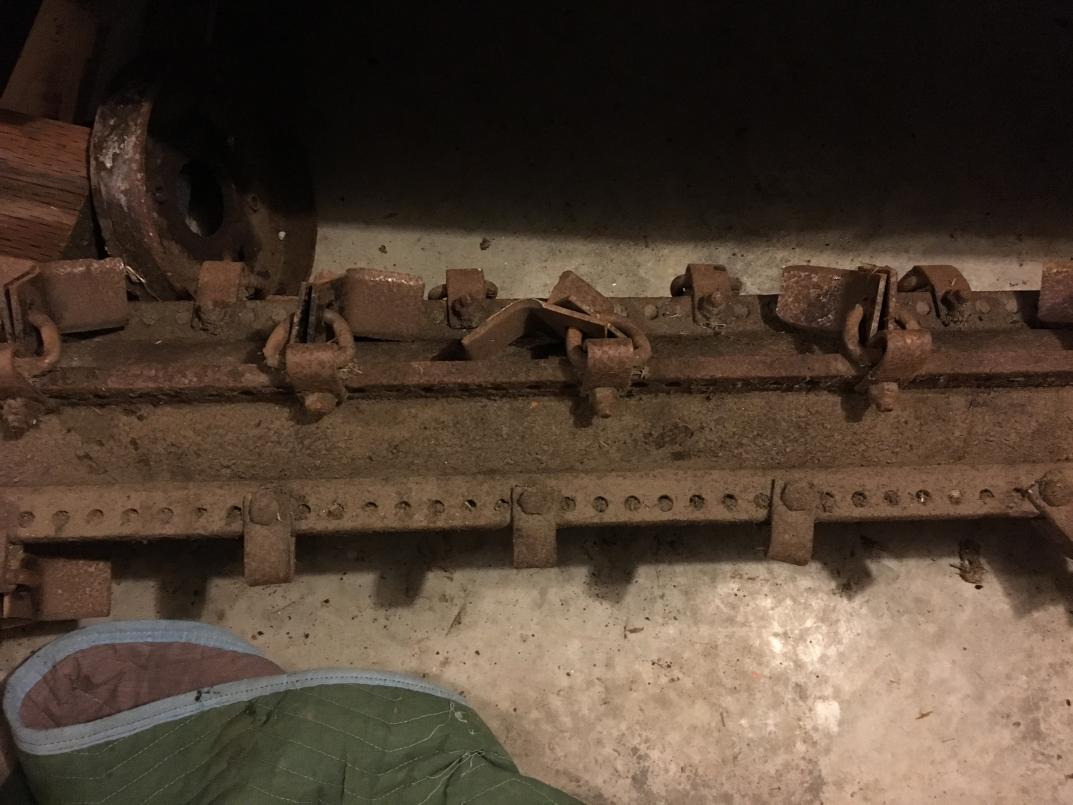

Found a 72" Rears SPF flail mower on craigslist for $1500. Seller did not include the pto shaft in the sale. I rotated the unit and all bearings/gears felt OK so I bought it. Got it home, bought a new pto shaft, and hooked it up to the L4701, When I engaged the pto the mower shook so violently that I thought it would throw me off the seat. I quickly shut it down, unhooked the mower and rolled it into the garage on a couple of furniture dollies. The pictures below show what I found...lots of missing d-rings and blades. Maybe a bit out of balance? LOL Parts are on order and I am confident it will work well when reassembled.

My experience with a MOTT flail was missing knives meant bad vibration.
Also, post photos of your pto shaft. Unlikely the problem but one that is not indexed will vibrate like crazy.
I think there was another drive shaft on the unit so post photos of it was well as something funny there is more likely than the new pto. It was a new pto right?
You cut it to the proper length with the correct overlap?
Back again. I looked at the second photo more closely. There are no knives and rings on one side of the rotating part. This is a serious imbalance.
Take all knives and rings off and I will bet your vibration is gone.

I'd bet a fairly large sum of money on the missing blades and d-rings being my issue. I am certain I cut the pto shaft correctly and the pto shaft connecting the gearbox to the drive pulley has good u-joints. Not much else to vibrate.
