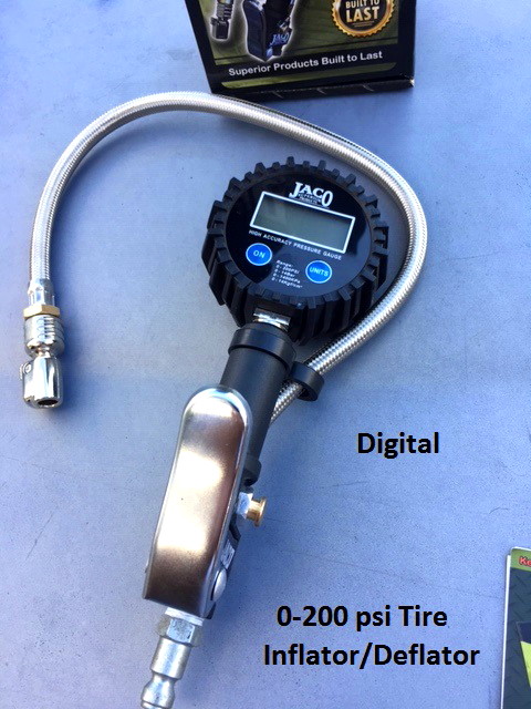

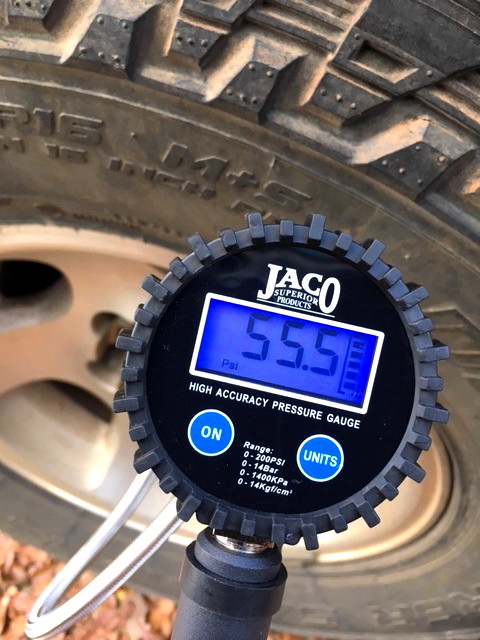

You can get an inflator with a whip hose to make life easier.
Yep,
Makes it much easier to inflate the tires.
The one I have you simply press the 'chuck' firmly on the valve (no need to depress anything) and then press the small tab to release when done.
You can inflate or deflate at any time, making it very easy to accurately inflate to a certain psi.
