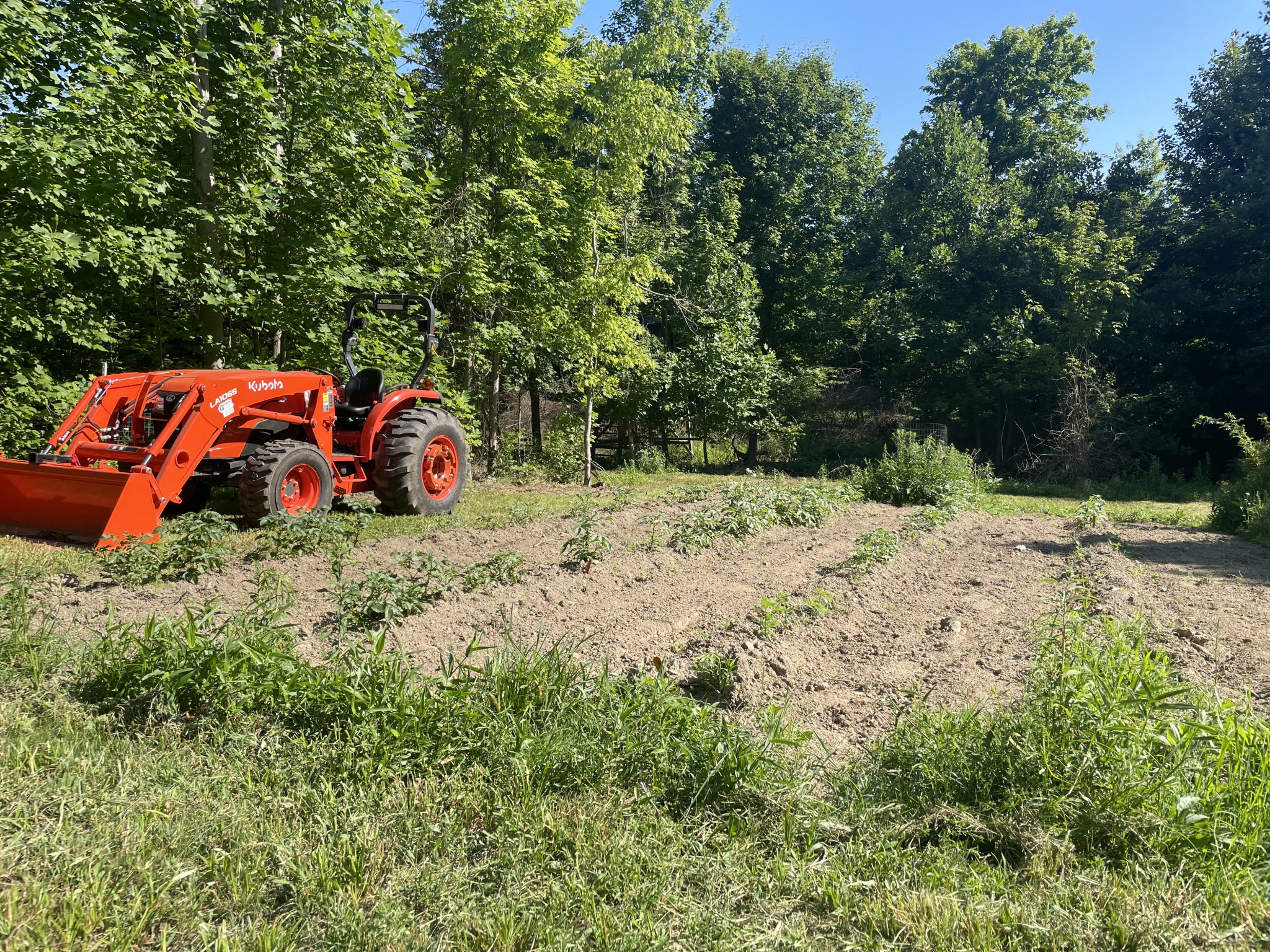

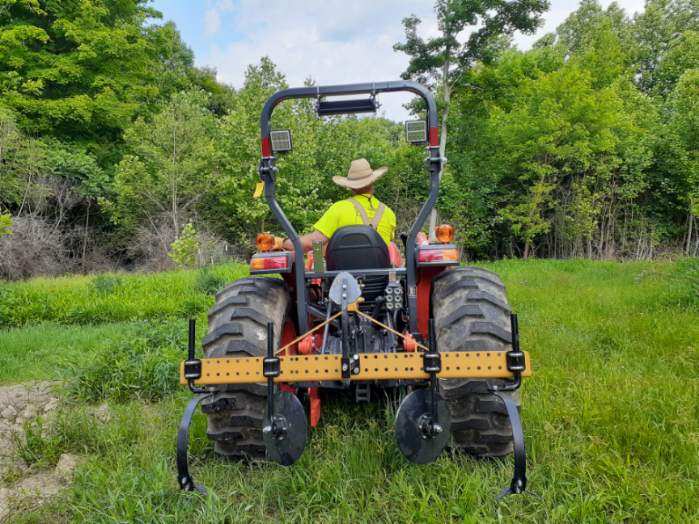

Good day. I have them on my MX (Ihave loaded tires too). I’d now like to have them on my B. I can’t imagine what type of problem you might have honestly…could you be more specific? What jobs trying to do or what implement trying to use and what is actual problem? When do you need the ballast…is it for ground pressure to create traction or for roll over stability / uneven terrain. Mine is just fine whether I am in the field with tiller or garden bedder, in the woods skidding trees or using my backho. A little more description would help us understand your struggle and maybe your question/ concern.
