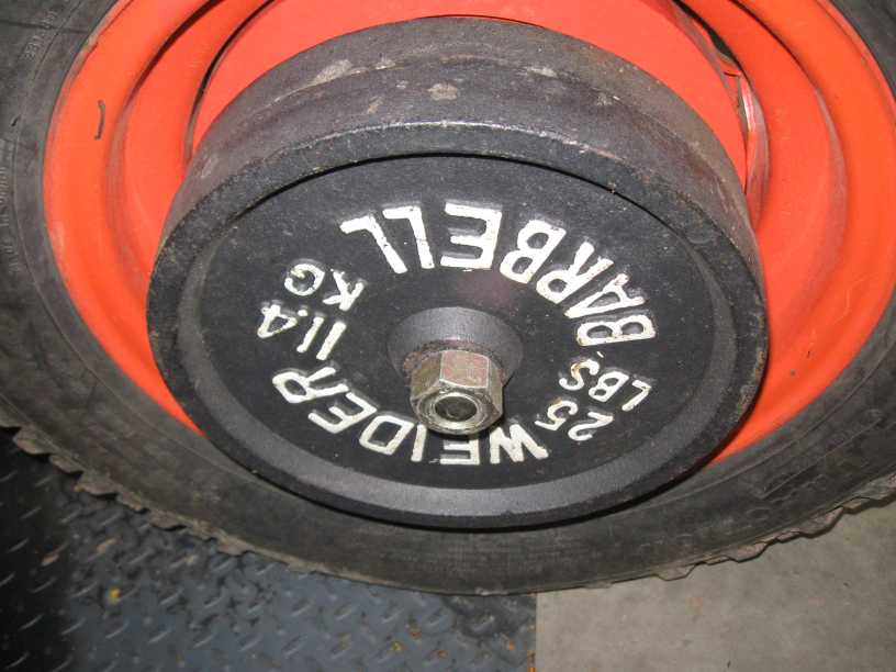

I know this is an old thread , but I thought I would add my home made weight pictures and maybe it would help someone with a new idea.
I took 1/2 inch thick flat bar and made a bracket , welded a grade 8 1 inch bolt in the middle. went to the scrap yard and bought bar bell weights for 22 cents a pound and put 100 pounds per wheel, and since the tires are loaded with liquid this gives me plenty of weight for loader work. I used ( 3) 25 lb weights and (2) 10 lbs weights (used to clear the valve stem) per wheel. This plus the bracket is about 108 lbs.
cost about $30.00 per wheel

I see the pictures did not load so I will try again

Nice. Clean, simple installation. If your land is as "treed" as mine, you will have to be careful about "collecting" bark. Don't ask how I know. I think I'm keeping the companies that make pruning sealant in business.
14,168
2,828
That Sir is one of the best used for bar bell weights I can think of
