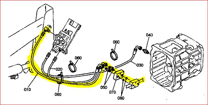

Thanks Wolfman, answers my question but raises a couple more questions if you don’t mind. Before the FEL was installed, which was done prior to me, it appears in the manual there was no connection to the tranny where the PB is now connected. It looks like it was plugged, see RETURN.PDF.
Was hyd pressure prior to the FEL supplied to the 3pt through the hardline? See HL.PDF.
Sorry for all the question, I’d like to understand the full system rather than just install the valve.

Ok, I think you are mixing things up.
The line that you are referring to is not PB, it's return or tank.
Power for the loader comes out the block on the hard line and back in on the same block as PB from the loader to the three point.
POWER OUT= Power from hydraulic pump to loader valve.
POWER IN OR PB= Power returning from loader valve to circuit for the three point use.
Tank or Return is a third line (not shown in this picture) from the loader valve for dumping extra or overflow fluid back to the case or sump.

You are correct, there is a bit of confusion on my part. The confusion comes from the PB port of the loader valve going to the return on the trans. See pic.
If I'm understanding the system correctly I should be able to move the PB from the loader valve (that presently goes to the trans) to the "in" of the new valve and the "out" back to the transmission return?
Or the the PB from the loader valve (that presently goes to the trans) to the "in" of the new valve and the "out" back to a T at the block on the hard line and the PB of the new valve to the trans return.

You need to look at the lines very closely, as that PB does not / should not go to return on the side of the case.

Bingo, I cut the tie wraps off to separate the lines and I see the correct layout as you showed. Now that makes sense.
Thanks for getting this straightened out.
