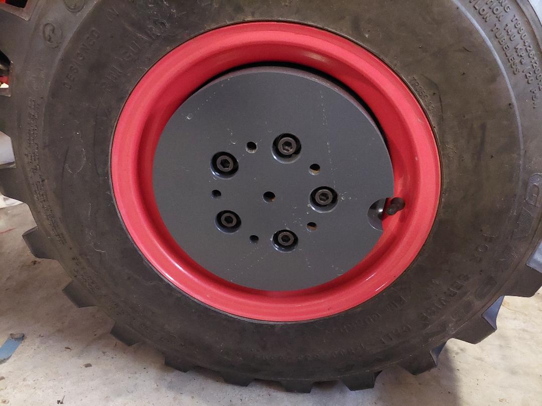

I keep seeing these plastic cement filled weights. That just doesn’t seem like it would last on a tractor. I’d much prefer steel.

Any older garden tractor wheel weights should fit your BX as long as they are for 12” wheels. I have a set of steel weights on my BX24 that I originally made for one of my old Cub Cadets. They are 52 lbs each.
I also have 1-1/2” wheel spacers to keep the tire track width the same as the loader bucket.
