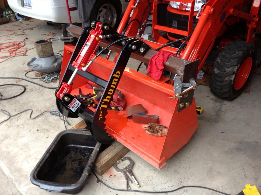

I plan on running the other set to the front for the "Thumb" grapple I'm mounting to the bucket, I figure the horizontal action on the joystick can work for either the rear tilt or front grapple cylinder by switching the connections.

Got to test run the THUMB grapple yesterday and should get it all painted and mounted today. This is going to be COOL!!!! :D

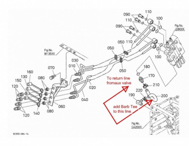

I have this one, but that doesn't tell you much about it. My model has a external line that feeds the 3 point lift from the loader valve, which made it very easy to add this aux valve. I just ran that line though the aux. valve then feed the 3 point lift from the power beyond port of the aux. valve. There is 1 more hose not shown in this picture, it is a low pressure return hose that I spliced into the return hose that went from my loader valve back to the side of the transmission to dump back to the tank.
It is very simple one I figured out what everything was. 3 weeks ago I didn't know squat about hydraulics but a couple of guys on MTF had added Aux. valves to their B series tractors and helped explain a lot .
There's a few diagrams I posted there that show the stock lines that may help explain a little.

Ohhh I see your model has the loader valve up front attached to the loader, that is a bit simpler I believe, I saw a few examples posted others had stacked there remote valve over the loader valve on similar models.

I had replied to one of your other post before i found this one. thanks . Any suggestions for me as im looking to do this to mine? can you link to the diagrams that were alluded too?

I can show you some photos but it I had a problem seeing exactly where it connected in others photos.
These diagrams explained it better I think, and once you get under the tractor and see where the connections are, it is pretty simple really. I should probably mention I had to remove the rear right wheel and the right rear fender to get good access to the FEL valve power beyond port and the return tube. But they are easily removed and reinstalled.

This is the low pressure return under the FEL loader valve to T into.

thanks that helps a lot. after you removed the banjo fittings on the hard line did a std o ring fitting screw right in? I'm surprized that the return is just a clamped fitting. Your control is a loader controler?
Yea the bolts that are removed are replaced, I think they were SAE8 o ring to JIC6 but don't hold me to that I remember taking them to our hydraulic supply house here for them to match up.
Yea the return on the loader valve now is just attached with hose clamps.

I Had looked at the loader valve too,any situation where the float position could be used? The one i looked at you had to buy the power beyond adaptor separate, is it just a fitting with a groove/passage inside to let the oil continue on to somewhere else?

The valve I used has float on the down vertical position. I read many recommendations to have a float option on at least one if not both remotes, I really haven't found a need for it myself, but it's there if I need it I guess..
I had to buy the PB adapter separately too, it replaces a plug in the valve to feed to down the line. That is where it goes to the 3PH.
