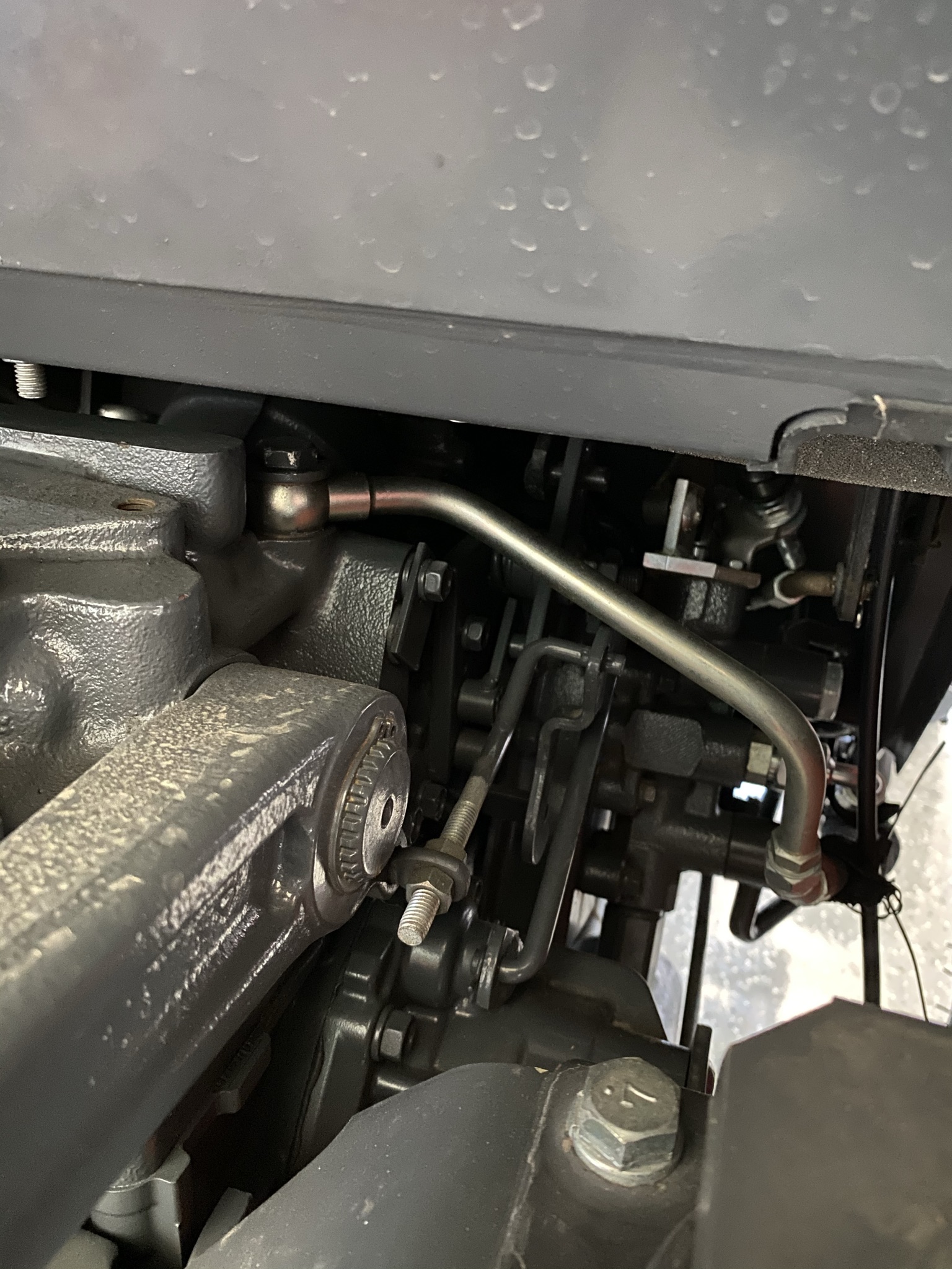

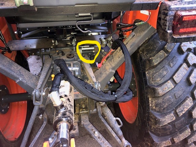

Need hydro advice on adding 2 sets of rear remotes to a cab model LX, please. New to tractors and didn't think I'd need them when ordering the machine. Got a box blade and only recently discovered "top 'n tilt" and of course I gotta have that now. Priced parts from Kubota and they're crazy expensive, even if using my labor. Looking at Summit Hydraulics' Z-50 Monoblock Solenoid Directional Control Valve, 2 Spool. Will this work? Where would you mount it? I have the Kubota third function valve so I need to find a P port somewhere to get pressure to it. The return line from the 3FV looks like a hard line with a banjo fitting to the axle; would I get a similar banjo fitting and stack them using a longer bolt? Thanks for any help!

Do you mind posting the diagram above the third function valve to see what the valve type. (open/tandem center) Yes the shiny hard line is the pb from third function valve. You would need to buy an 90 degree orb to jic fitting to replace the banjo. It should be jic line from 3rd valve to P port of aftermarket valve, and T tank from aftermarket to existing banjo port on housing. This is assuming the third function is either an open or tandem center.

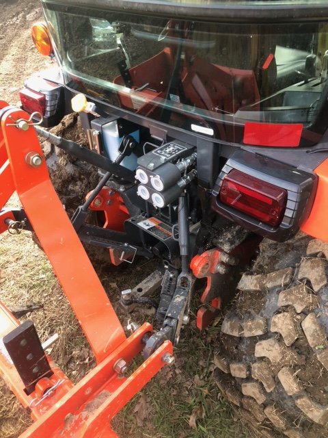

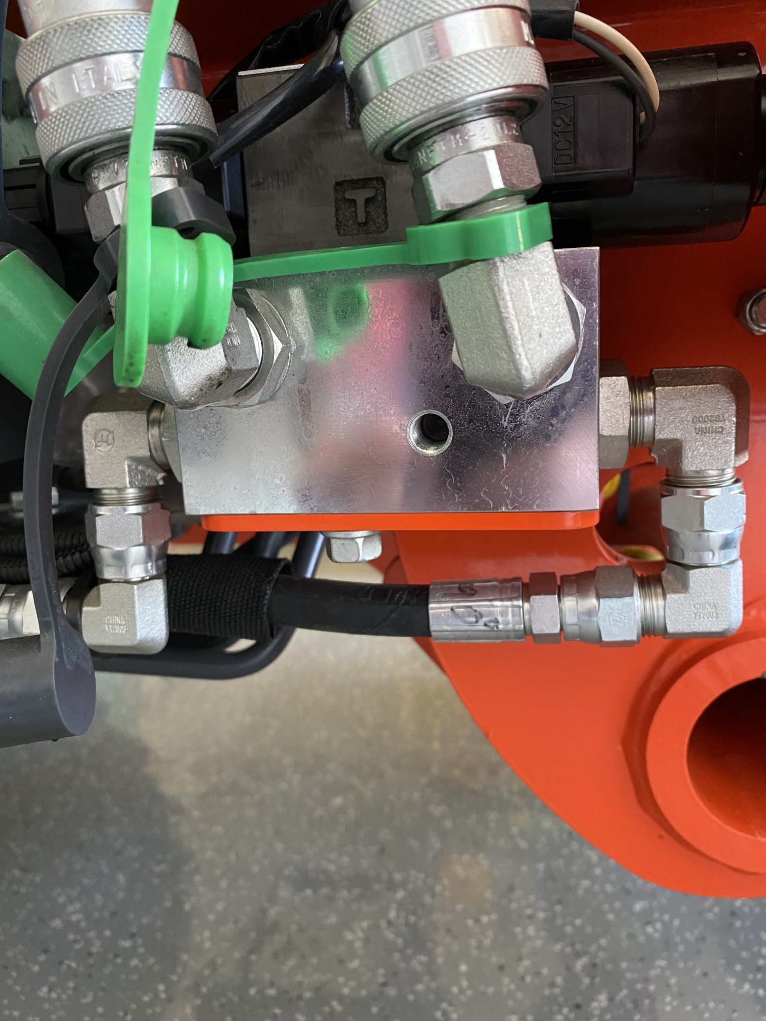

I have a 2610 with a cab. Here is a pic of where the kubota rear remotes mount. I hope it helps

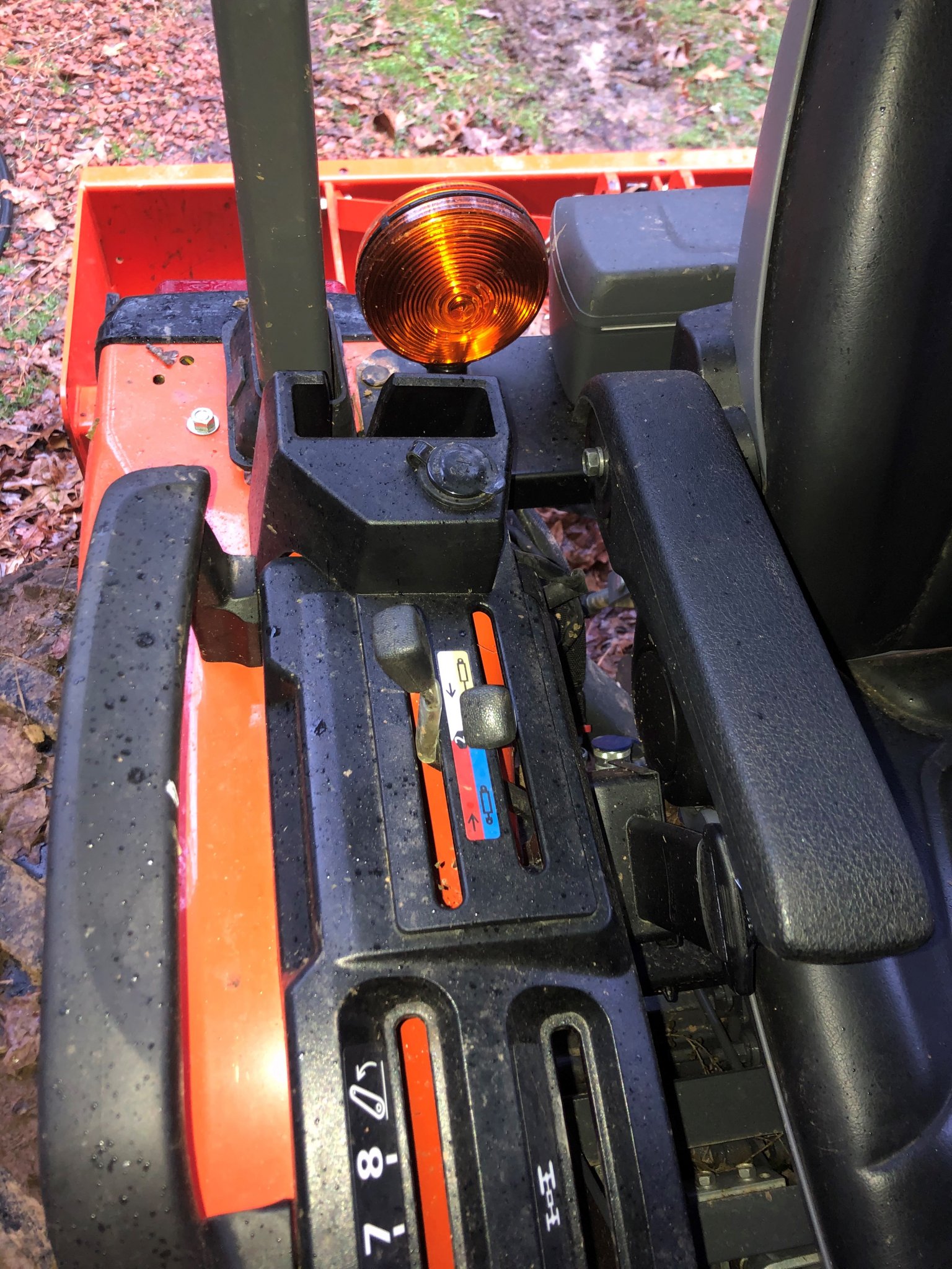

Here is the piping for the factory remotes on my 2610 non cab, as well as the levers.
I can't help with your other question.

Do you mind posting the diagram above the third function valve to see what the valve type. (open/tandem center) Yes the shiny hard line is the pb from third function valve. You would need to buy an 90 degree orb to jic fitting to replace the banjo. It should be jic line from 3rd valve to P port of aftermarket valve, and pb from aftermarket to existing banjo port on housing. This is assuming the third function is either an open or tandem center.
Hmmm.....I have another pic from a slightly higher angle but no diagram. I also just checked my folder for a manual on the 3FV but nothing is there. So you are saying the shiny hard line is pressure, and not return? I'll see if I can find out if the 3FV is open/tandem. Also have a pic of the loader valve but you can't see much since it's so tight in there. Thanks!
Definitely nice! Thanks for the pic. Here is the quote I received:

Shiny hard is return to tank of pb circuit. When you break into the line for third, it becomes a P for the third function. The return goes back to the housing as a tank port. We are saying the same thing it just depends on what is feeding to tank(which end your talking about) You should be fine, the factory valve manual does not specify non backhoe capable. So the factory third valve is probably tandem center. There is a diagram printed on the top of the solenoid valve. If by chance it is a closed center, it would not work to feed the aftermarket valve. The landpride manuals usually state this as non backhoe capable.

Shiny hard is return of pb circuit. When you break into the line for third, it becomes a tank port. You should be fine, the factory valve manual does not specify non backhoe capable. So the factory third valve is probably tandem center.
Thanks! That's what I thought. Just getting used to the terminology....pb return makes sense.

Thanks! Very interesting how that valve block is mounted. I wonder if it's compatible with the 3rd function valve.
Not sure, as I have a summit 3rd function that I installed.
