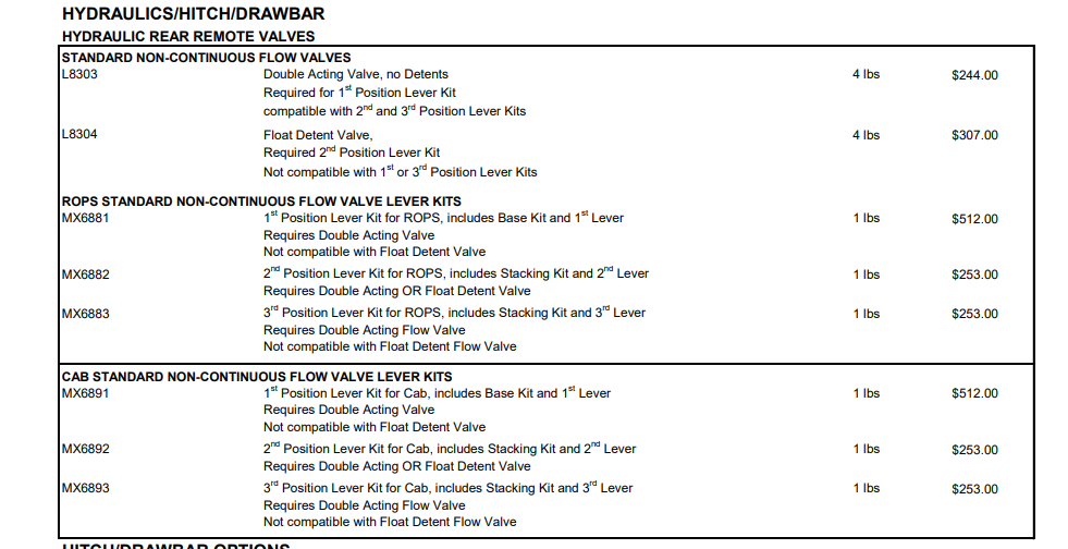

Hey Rip,
I have MX5400 being put together as we speak. I'm adding (3) rear remotes. Easiest way to get your parts list would be to go to kubota site and configure a new build and the remotes which will give you build sheet with all the parts needed.
In summary:
1st position lever kit: MX6881
2nd position lever kit: MX6882
Valves L8303 double Acting or L8304 float type.

Here ya go @Rip.
Here is the screen shot. Prices may have gone up a bit, this is from 2020.
And here is the link for everything MX. The 5400/6000 start on page #9.

That I cannot! But I ordered 2 more for my MX in June, and they arrived a week later. Install was easy also.
