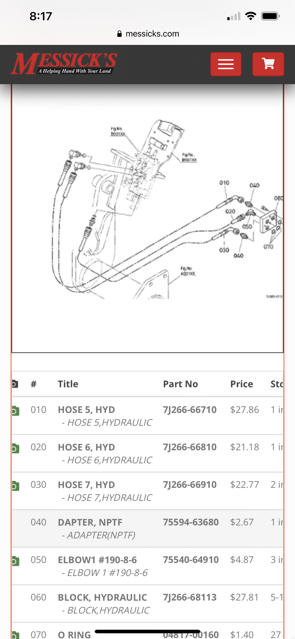

This might help (hope the link works right) parts list for the 4988 subframe kit for the 2501. Will get you part numbers, unsure of availability on them.

Had another thought on this…
Did you end up buying a used backhoe and are you getting the correct subframe kit?
If so maybe you could get the seller to include the hoses. Maybe they have the original PB hose laying around to put back on when remove back hoe hoses? If not that hose would be a lot cheaper and easier to buy and supply the seller then try to piece the back hoe hoses together with the Kubota parts.
If sellers tractor has added hydraulics other then the back hoe it won’t be this simple though.
hose 010 in diagram would be the hose if you had to buy it for the sellers tractor.
