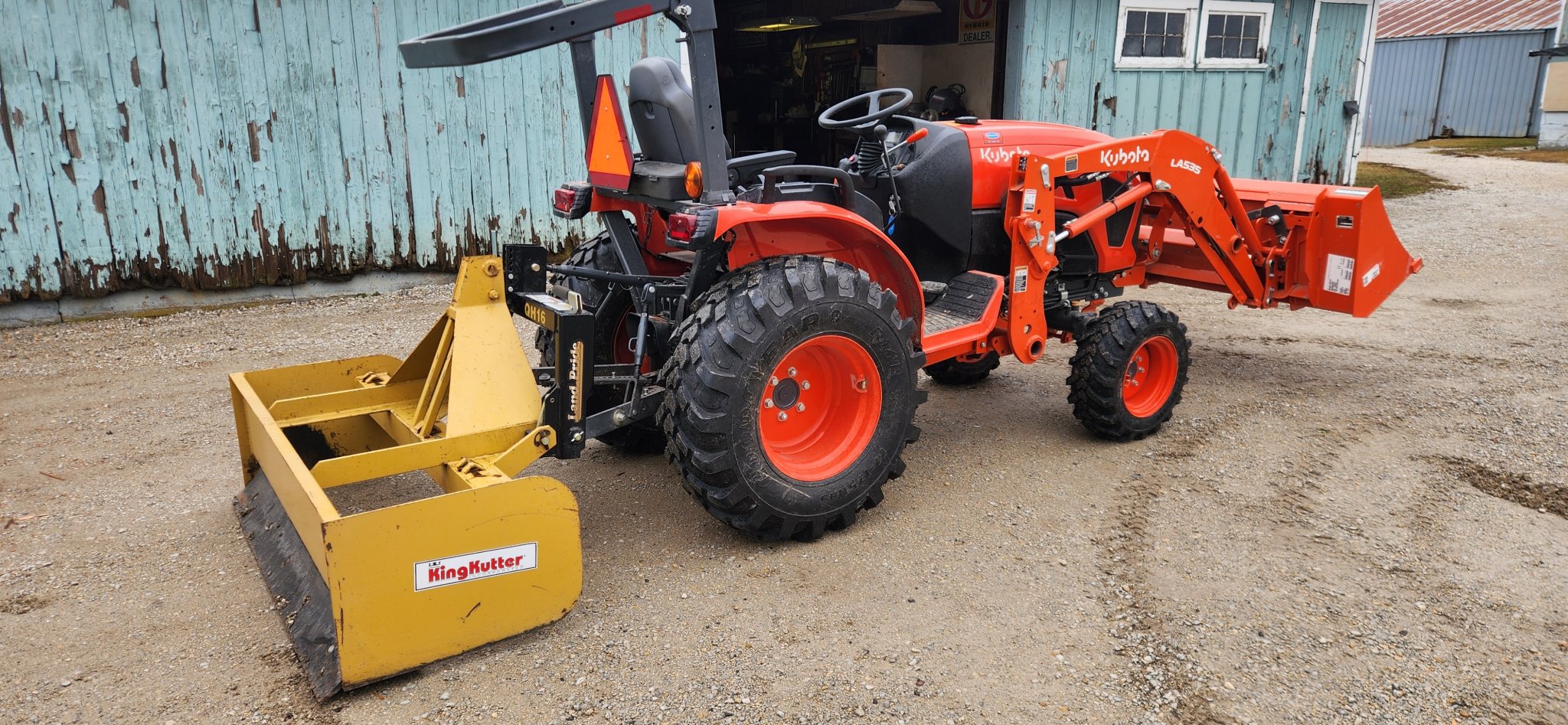

Nice to see another SE Wisconsiner on here. I also own a lx2610. This is just my opion but I'd never buy a new blade........just seem very light duty and all look/designed the same. Online you can find used ones but usually over priced(cheaper than the dealer though), beat up and rusty. At farm or consignment auctions these blades are given away. 50.00 to 175.00 sometimes. I got a heavy duty Dearborn 6 foot blade and did some work to it. It is heavier than the newer blades and I can tell it's on the tractor. I'm actually looking at getting rid of it for 300.00 obo. The only downfall of buying older stuff is it's not 100% quick hitch . It works but not just back up and go. I use mostly a box blade and that's even heavier than the rear blade.

I agree about old back blades not being worth much. I have a mid 70"s Massey Ferguson six ft blade my parents bough new. I have asked dealers twice about trading it in, and both times they said, if you have any use for it at all, you are better off keeping it, as they are not worth much.
After almost 50 years it is still in great shape, so a good quality one will last forever. My Kubota dealer does not even stock them, as the few people who want them buy used.
I like to have 1 tool for multiple jobs. The box blade seemed ideal for dirt and snow.....pros and cons but for what I paid for the rear blade it can sit behind the barn until I need it. Or sell it for something bigger.

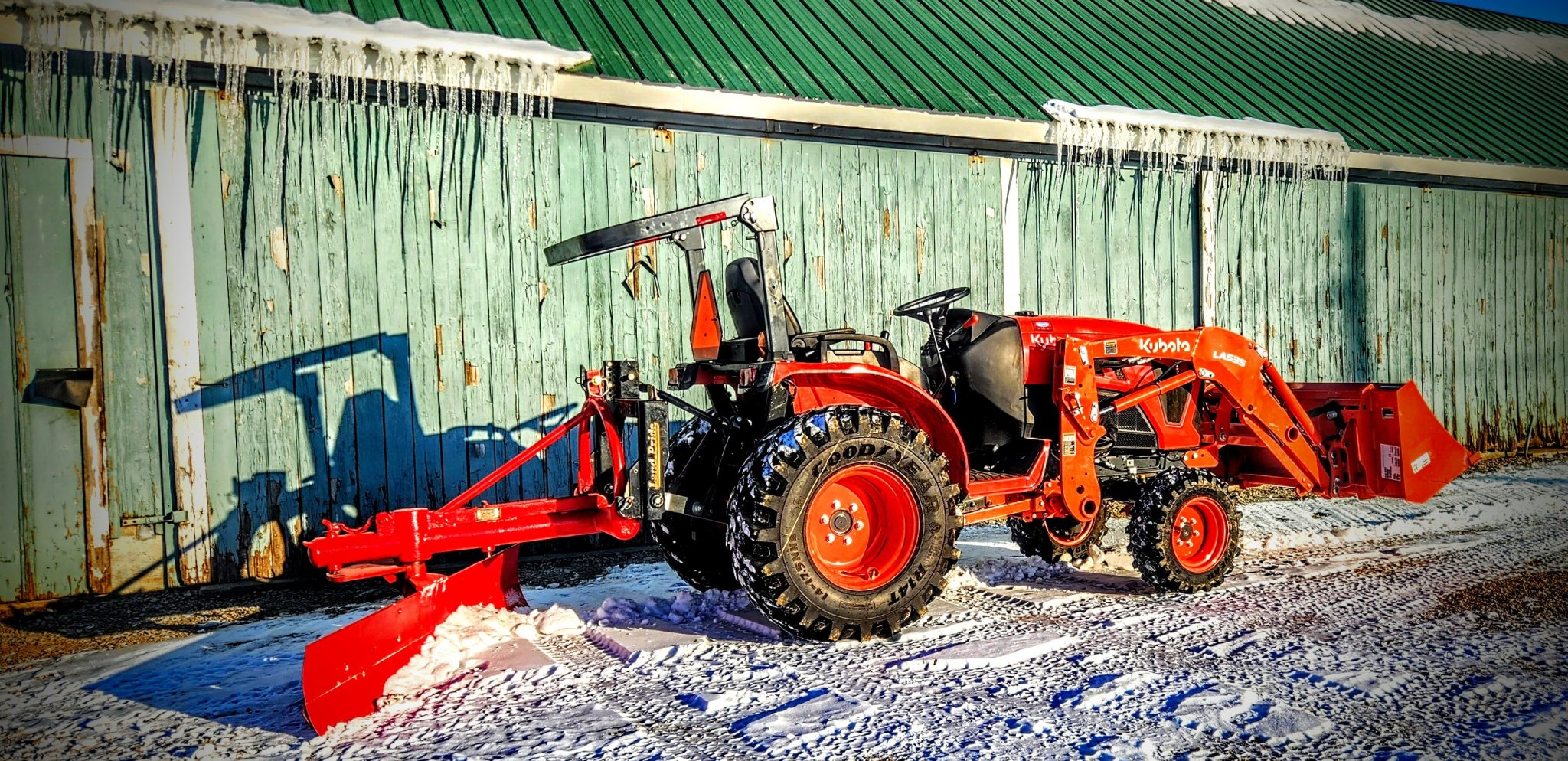

I have a RB1684 on my LX2610. When I have it angled, I still get good coverage past my wheels (with 2.5" spacers). Not sure of the weight. I bought my speeco quick hitch from Good Works Tractors and I believe they have a weight bracket to fit on the quick hitch if you want to add more weight.

I use it primarily for snow and it works well. Especially with wet snow that the blower won't handle. Also used to drag snow away from the buildings. Haven't had a need to use it in dirt.

Closing the loop on this thread. I ended up buying a Landpride RB1672 from my dealer, $1400 included tax and delivery. It is Much more $ than I wanted to spend but couldn‘t find anything used nearby. I was ready to buy from Everything Attachment which was recommended here but they are back ordered for 4 or 5 months. We probably wont get any more snow but I’ve already done a little driveway grading. Thanks again for everyone’s comments and suggestions.
I have the same tractor and I am undecided on rb1684 vs 1672. I was primarily going to just use for snow on driveway but will eventually find ways to grade with back blade. Is the 84 too big and causes issues bogging down when grading and or just seem too big on the tractor? I can pick one up used for 500 whereas the 1672 will be 800 with skid shoes
