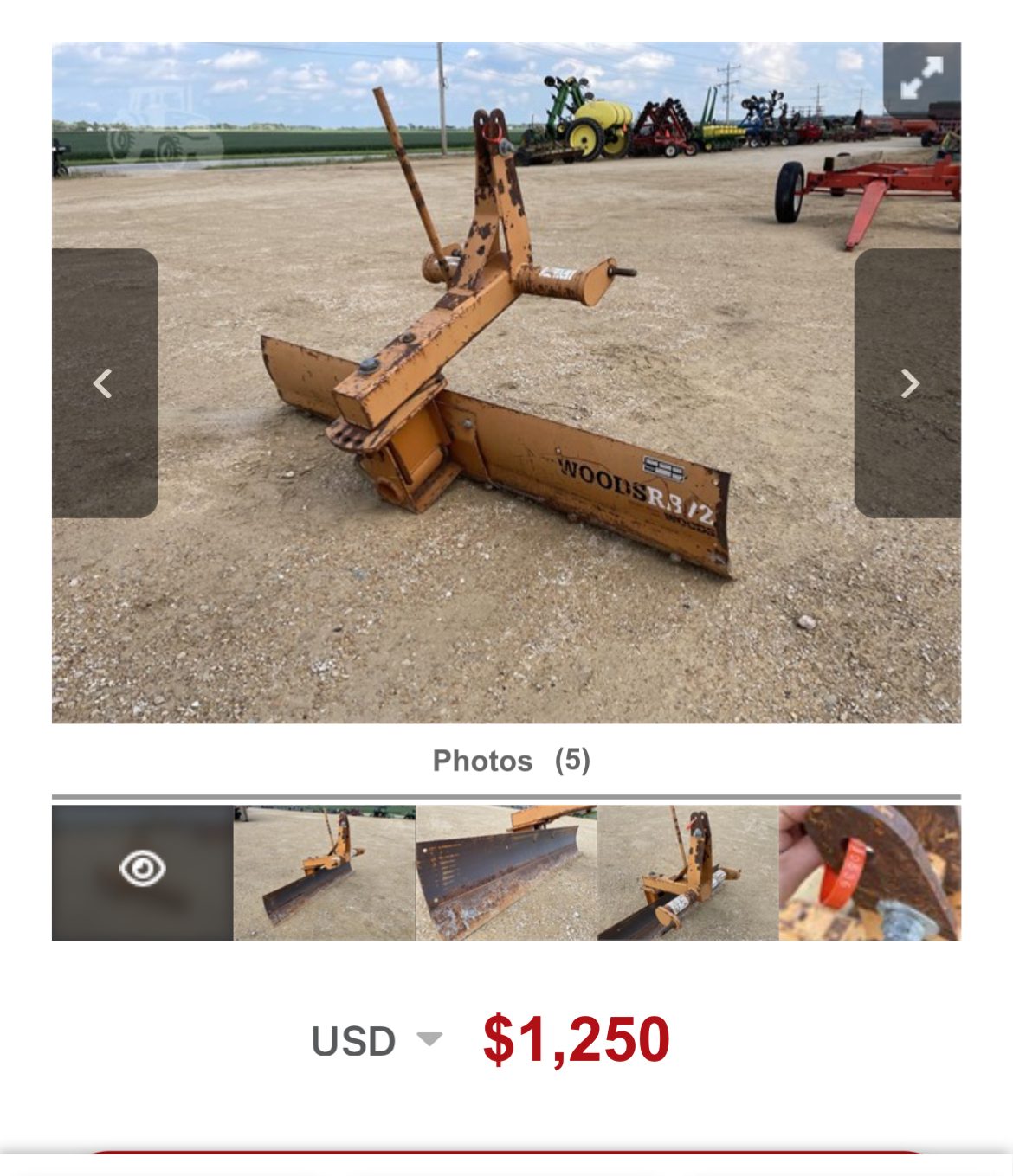

The older Woods rb6 rear blades are 231 lbs. You could find one on Craigslist like I did. There is one for sale on equipment trader for $575. Private sellers can be cheaper....mine was $125.

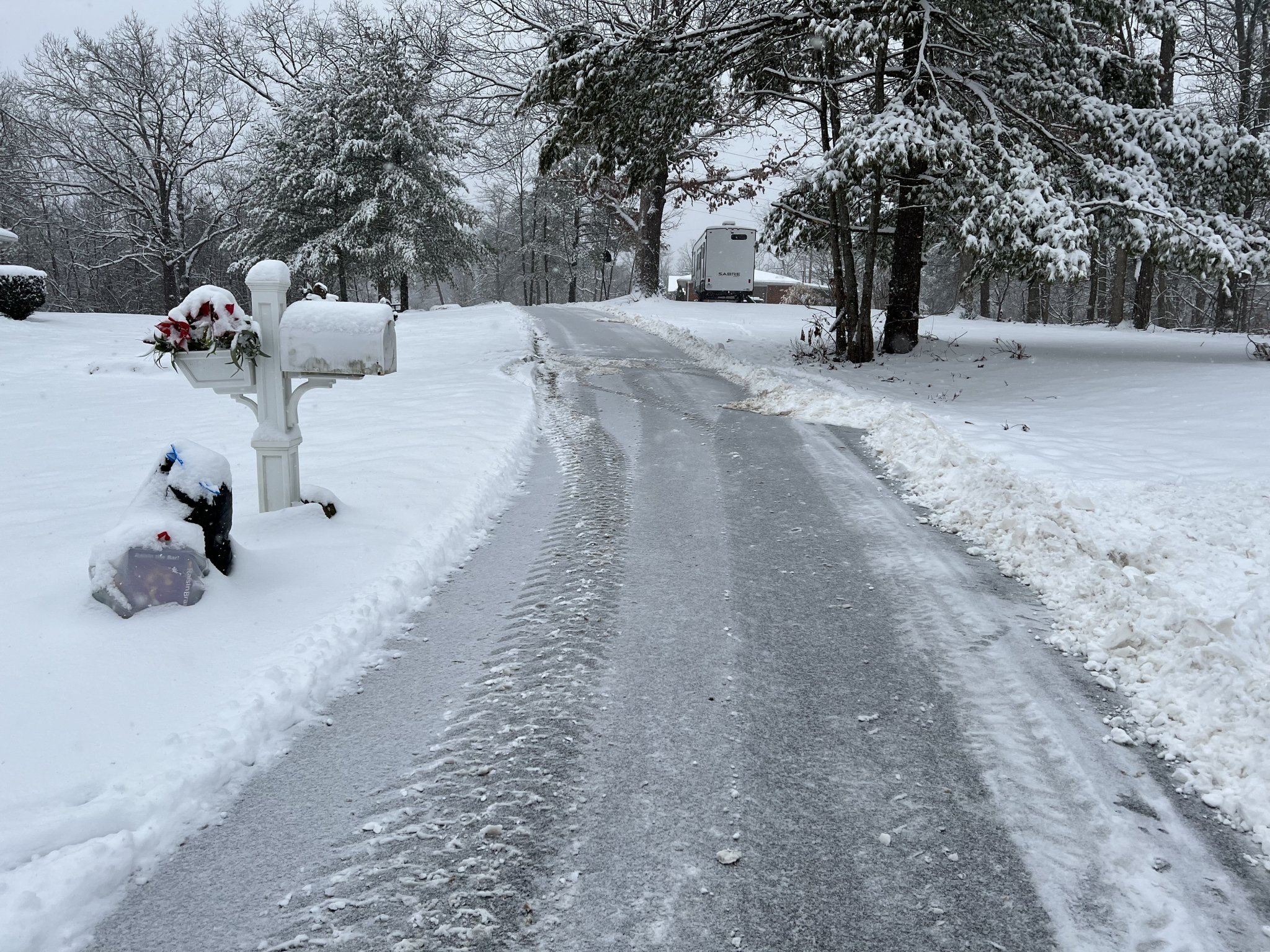

Simple answer, that sales person has never operated a tractor with a rear blade for any amount of time, thus having no idea what should be recommended for that size tractor.
A 72" blade at a 35* angle only cuts a 58" wide cut. I don't know about all of you, but typically that would be the least amount of angle that I would use.
Recommending a 60" rear blade for that size tractor simply shows how much the sales person doesn't know
As far as the weight, heavier is better, but keep in mind that regarding ballast, that rear blade is further back than your ballast box, so less weight can provide the same results that the ballast box provides.
Here is the rear blade that I recommend for your LX in an 84" width.
