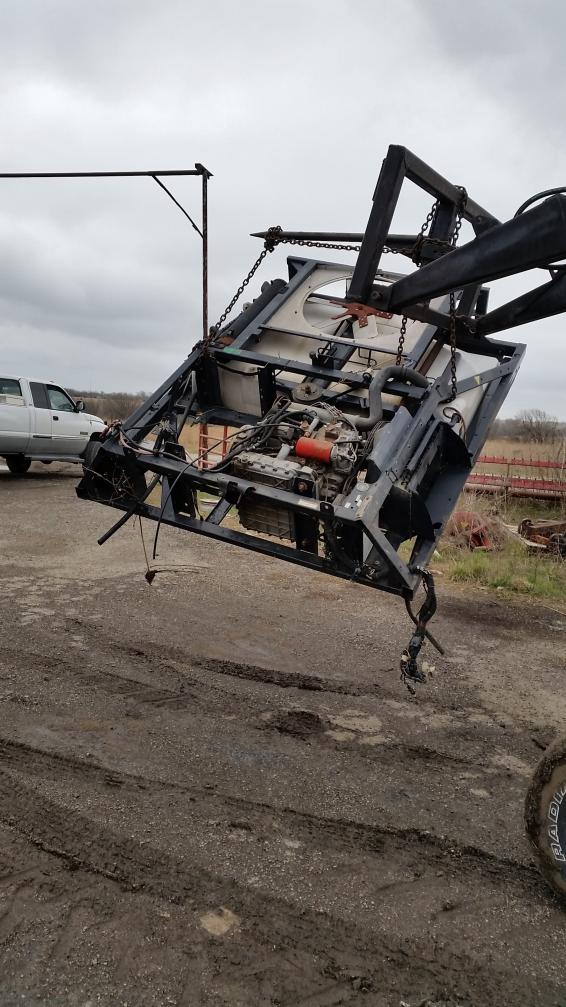

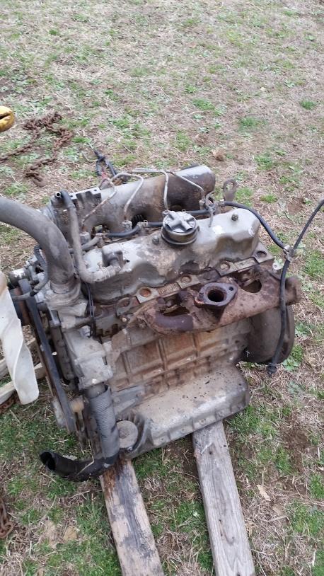

New project. I got this beast from a local farmer who said he smelled antifreeze when he ran it. He had a mechanic remove the head. Mechanic said he though a sleeve was cracked. Engine difficult to find and expensive to ship, so he sold it.
The engine is a Perkins 4108, four cyl. 108 CI. Often used in sail boats, various brands of skid steers in the USA, but many industrial and automotive uses in Europe. It's a wet sleeved engine so that adds considerably to rebuilding costs, because the sleeves need to be removed, then new sleeves installed, then machined for new piston... so a Kubota V2203 came into question.
I have a friend who works on big tractors, up to 250HP, and he loves Perkins engines. I remember finding a Massey Super 90 setting in a barn yard a few years ago and he was over there the next day negotiating for it and had it running and on a trailer in an hour. I called him to ask about if he knew where I could get a Perkins or information or parts. When I told him what size I needed he said he never heard of a Perkins that small!
I mentioned to him I was thinking about getting an engine that was used in refrigeration units for trucking. He told me his brother's step-son had a trucking business and lost his refer contract, so he took the units off and sold them. He bought two of them and still had one out back.
So that's what is going into this Clark/Bobcat.

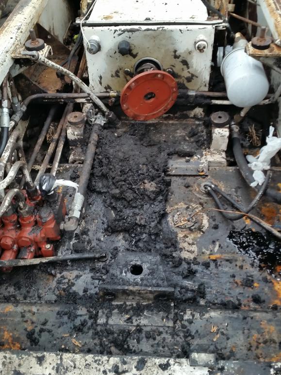

North Idaho Wolfman has been my coach! I have to adapt the coupling from the hydraulics to the flywheel. Need a different oil pan to have room so the engine crankshaft can line up with the hydraulic pumps. Have to fabricate engine mounts....

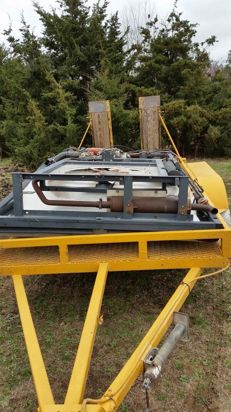

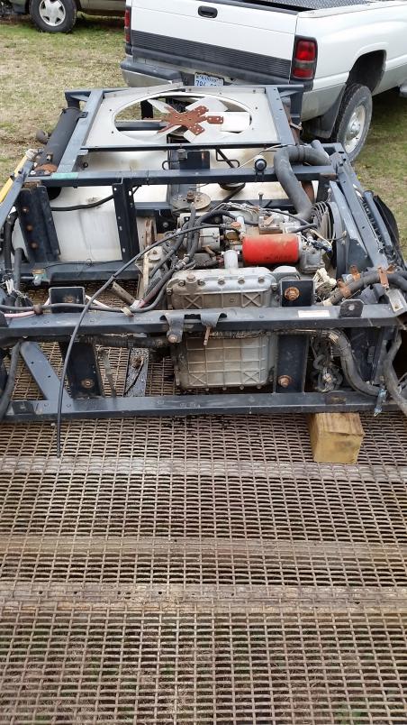

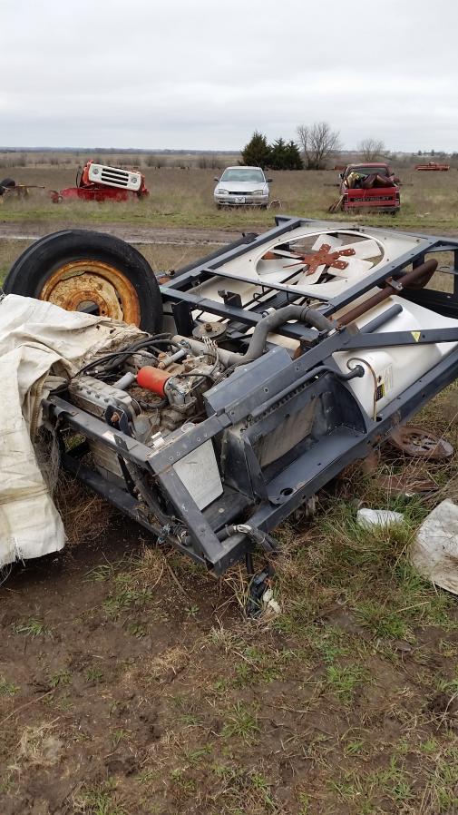

Here's some pictures. A couple of the skid steer, and it's filth, one in Martin's back field, then on my trailer, then removed.

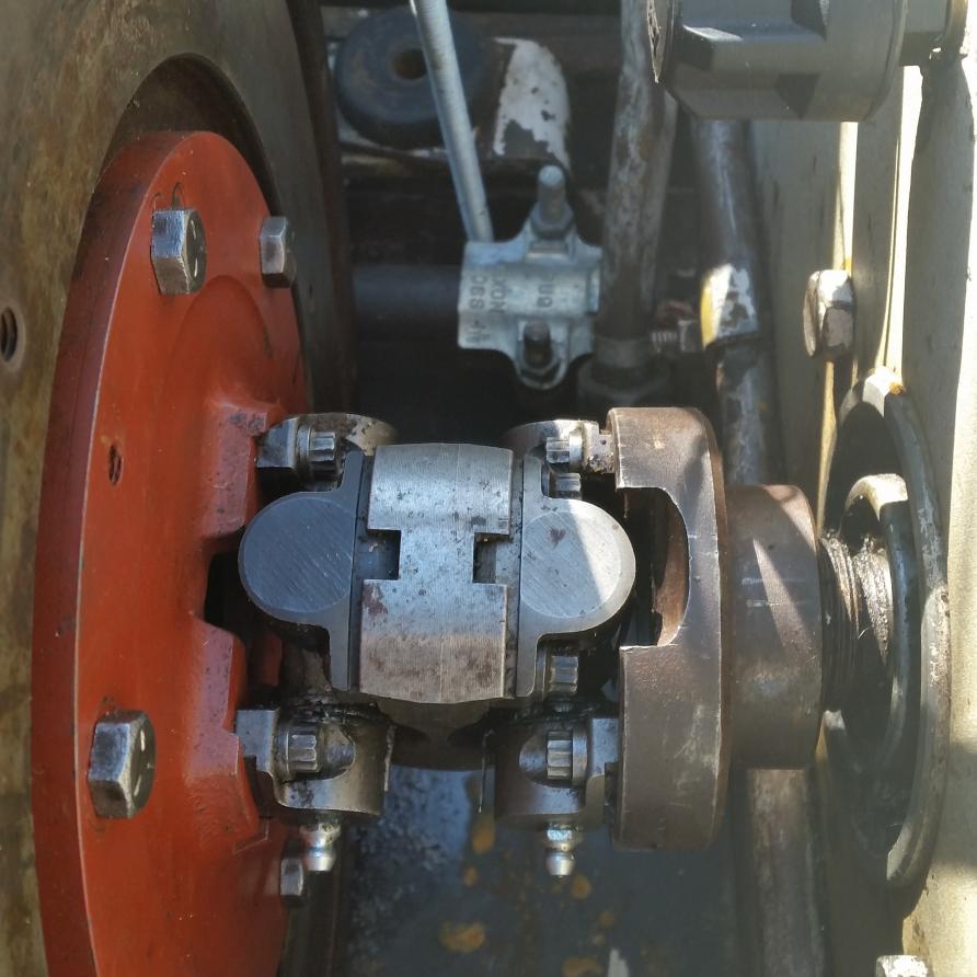

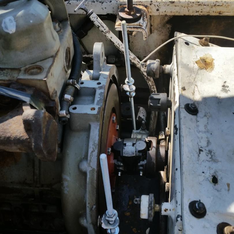

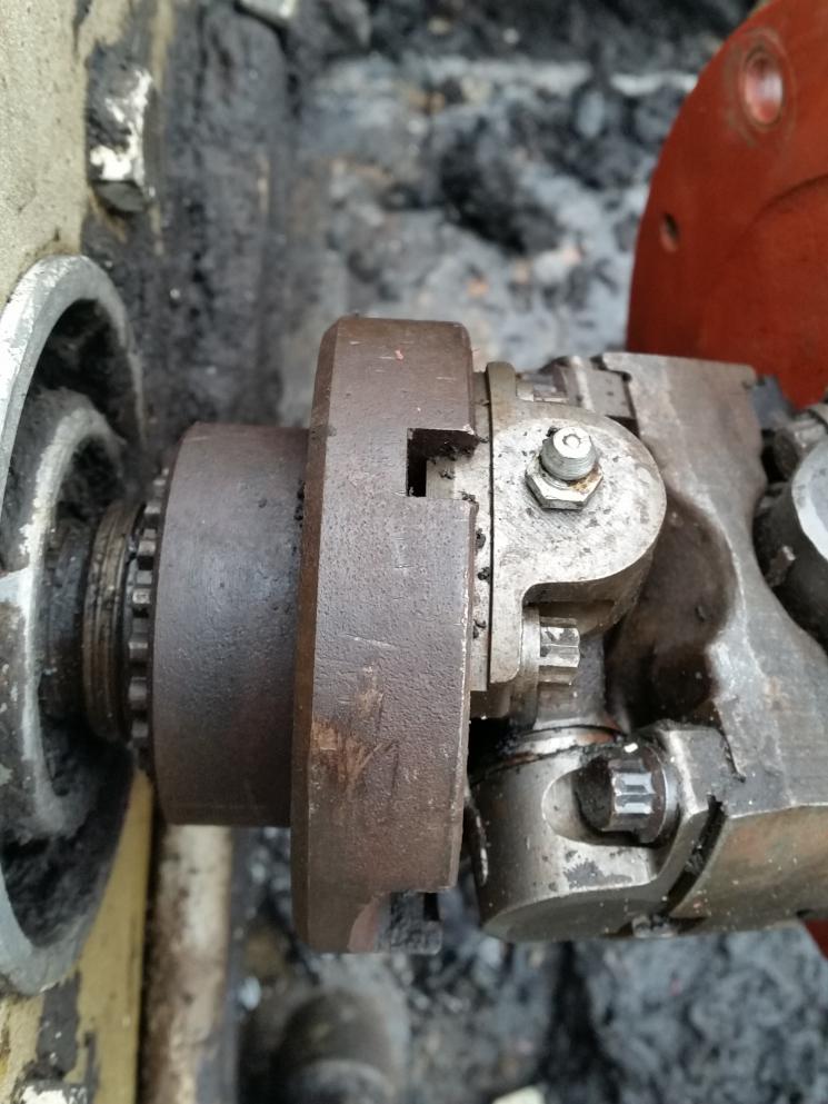

Got the flywheel machined to accept the flange that mounts the U-joint to the hydraulic pump. Replaced the refer style oil pan with a Kubota oil pan. Got the dipstick hole drilled and installed dip stick sleeve. Got engine set in machine. Built leveling rods to get engine in correct place to fabricate engine mounts. Have engine connected to hyd. pump.

I was trying to get the engine lined up by using wood pieces and then some shims like used for getting doors plumb. Every time I adjusted one, two would move another direction. Decided I need to come up with something different.
I went to my metric bolt selection and found a couple that threaded into the bell housing tapped holes. Just welded a heavy 1/4" thick washer onto the head of the bolt and used all thread with a nut at the top and bottom to make it stay. Pretty easy, simple, inexpensive and quick....and works!

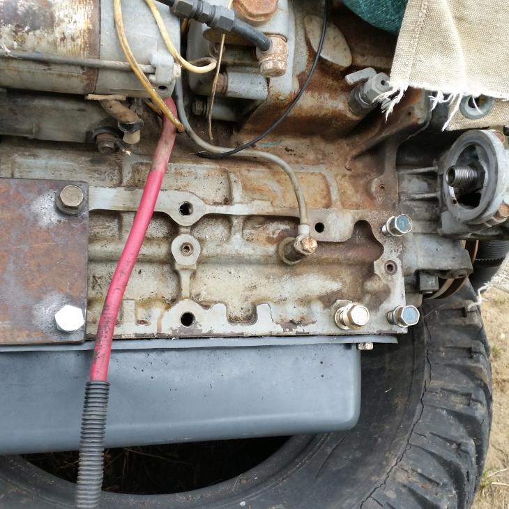

The Kubota V2203 engine got a steel oil pan to replace the one used by Carrier. It has a drain plug on the side and one on the rear.
I'm going to use the one on the rear. The pan needs a hose to go over to the right side of the skid steer frame where there is a hose barbed connection and a plug on the outside to drain engine oil.

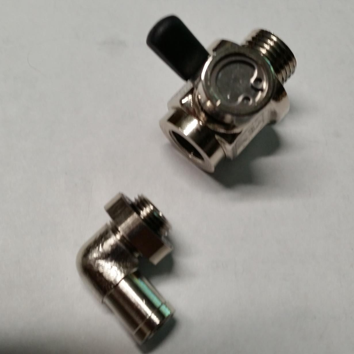

Not much room to play with, and I want a valve to reduce the mess when removing the plug. Here's what I came up with. EZ oil drain valve. Hose from the 90 to the hose barb with two clamps and done! Threads had to be 16mm x 1.5 pitch.
'Cat - looks like the ticket.
Had a similar setup on my JD425 tractor with a Kawasaki twin cylinder. That valve was brass IIRC. Always treated it gently......

Is there any way to safetie that valve closed? or is the plastic "clippy-doodle" for that purpose? Other than that, I am sold.
15,021
7,737
The valve is spring loaded and the lever has to be raised about 1/8" and then rotated 90 deg. to open the ball valve.
This valve is located in a place on the skid loader where nothing can get to it to even bump it, then a 14" piece of hose will get the oil to the connection on the frame, and then there is a plug on that!!
Yes, that clip is a "feel safe" device designed for "worry warts"!!:D:D
