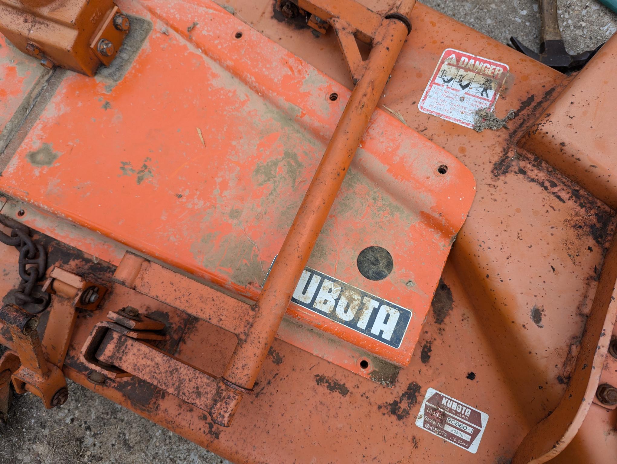

I decided to mount the mower deck that is original to my uncles' B8200 that he bought new in '84. Not sure how long the deck sat off the machine but I can gather it has not been in service for at least 15-20 years. I replaced the deck belt and blades and serviced the rest of the deck. I mounted it to the tractor last night and plan on a test run with it. I cannot find the manual that came with it so I have a couple questions hopefully someone here can help with.
1. Are the chains on the rear of the deck used to hold it up when not in service?​
2. What are the cut height increments for the guide wheels and rear roller?​
3. Does the deck raise with the 3pt at all?​
I appreciate any input you guys may have for me.

There's a sticker on the left side of the deck that is 99% faded. All I could make out was a Roman Numeral III. I bet that is what this sticker is representing. Initially, I thought it was the deck belt routing diagram but after seeing your picture, I bet it is the deck height adjustment. Thanks!
