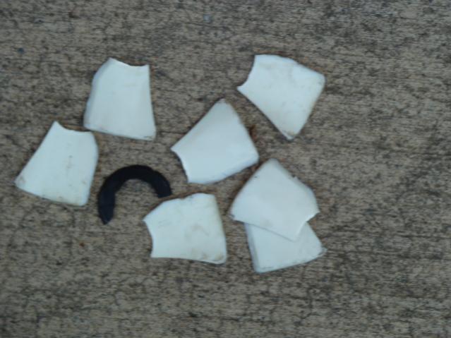

then I hear s loud noise and something cracking. I thought I smelled hydrolic fluid but was not sure. This all happened in a couple of seconds and things went back to normal. I knew something was not good but my BX24 didn't start to overhear or continue to make noises. After driving around in a circle I found these on the ground. How come there are no skid plates to protect anything? Does anyone make an after market add on? Could I have prevented this by somehow watching for sticks pointing a certain way. Geese this seems like a crazy idea. I admit I'm a newbe to the tractor world but no one warned me tractors could cost $ fixing things like this.
After further investigation I figured out ti was a lower HST fan driven off of a drive line much like one on a car (with universal couplers etc.) Amazing that they don't have something protecting entry. I'm gonna fab a skit plate to cover this area. Cost me about $10 from the kubota dealer for the part. They estimate it will take a few hours to install (have to remove the deck etc. to get access from above).
