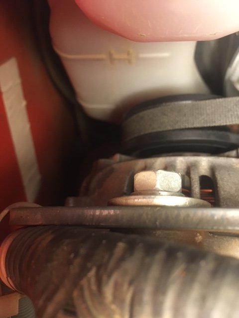

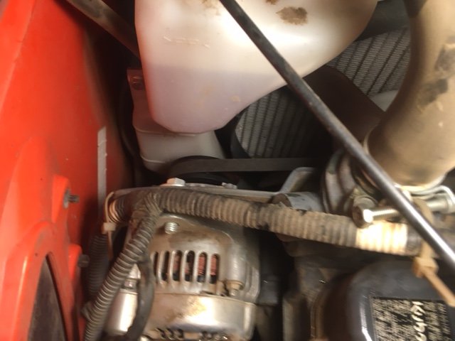

My display recently started showing this indicator on my BX2370, located just above the number of run hours indicator. There are no red warning indicators lights that come on otherwise. The manual says this indicates a low radiator fluid level, but my radiator is full when I check it. However, the overflow reservoir for the radiator is shown in the second picture, and there is a upper chamber and a lower chamber that are suppose to be connected. The pictures show the lower chamber with the High and Low level line indicators on it, and this chamber appears to be empty. So I thought this is what was making the dash indicator symbol come on. But When I filled the upper chamber with red radiator fluid poured through the yellow lid on this upper chamber, it seems this fluid does not flow into the lower chamber. The indicator light did not go off, and the dealership has suggested that I have a bad sensor.
Any help on this question, and can I wait until I bring in my tractor for the next major service before having the dealership fix the sensor, or am I risking damaging my tractor by waiting? I would rather not pay for a service just for fixing the sensor for this indicator if I do not have any other reasons to bring in the tractor.
Thanks

This reservoir is not for any windshield fluid, as the tractor has no cab.
The indicator is on all the time,, even when the engine is cold, so it is not indication an overheated engine.
I do have a manual for this BX2370 Kubota tractor, and it says when this indicator goes on, the fluid needs to be filled up to the Full line. That is why I filled up the reservoir, but the fluid only stayed in the upper chamber. The dealership said that these two chambers are connected.
They suggested a faulty sensor, but the manual says the fluid should be between the F and L marks on the reservoir.
The radiator is totally full when the engine is cold.
I am hoping someone has had this problem in the past and can help out here...
Thanks

I have had this problem on an automobile. The sensor was a float in the overflow bottle and it was stuck.

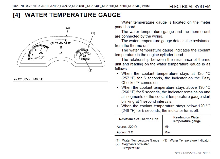

If you have not seen this operating description it might make things clearer.
I do not see any liquid level indicator.
I have not studied this system so these are quick comments!

That light is the coolant temp light. Unplug the wire from the sender, if the light goes out, it's a failed sender. If it stays on you have a wire or display panel issue.
The BX2370 does not have a coolant level light.
