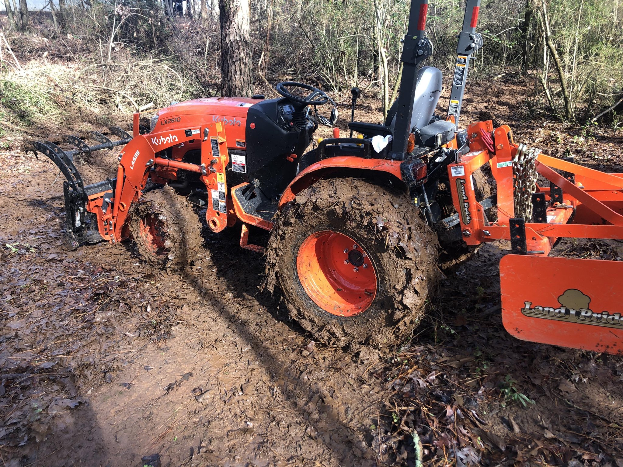

These are the larger R14’s on my Lx2610. They impressed me here. This is a usually dryish creek bed I was clearing privet of. They did cake up like you can see, but they kept pulling. I miss this little tractor.
