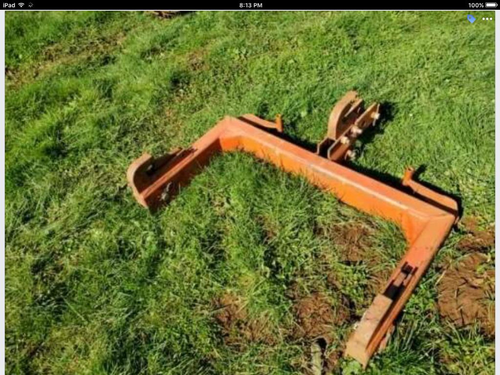

I have a Quick Hitch. It sits in the corner of shop where it’s out of the way because I got tired of tripping over it.
QH’s at first seemed like they’d be Quite Handy. But the problem is they actually don’t fit a many attachments as one might suppose.
In my case, I first wanted to switch between a shredder and a box blade. I thought this would be easy. But the problem was the shredder needed a different length top-link than the box blade and the box blade top-link requires frequent adjustments anyway, as well as the lift arms in order to accomodate “crown” or “slant” on the road or whatever surface is being bladed. Gotta get on/off/on/off many times anyway so the QH didn’t save any time and wasn’t convenient due to the lift-arm width-settings were different between the two implements.
Then, I bought a Finish Mower. And a Post Hole Digger. The PHD Will NOT WORK AT ALL Because the QH won’t hold the implement steady and the PHD flops around everywhere. The Finish Mower and shredder both require a loose/long top link to accommodate uneven ground or the support arms will bend on both mowers. The QH will not adapt to that.
For a QH to work as intended and in order to remain convenient you must have near-identical 3-point implements that do NOT need any flexible movement. Before wasting money on it, be certain your implements are QH compatible (and most likely will need to be the same mfr’r.)

I agree with all of the above. I do have a quick hitch and it works great between my bush hog and finish mower--the two most used implements I own. But it is useless with the PHD.
HOWEVER, the time it takes to remove it when it cannot be used is about 30 seconds. So for me it is perfect.

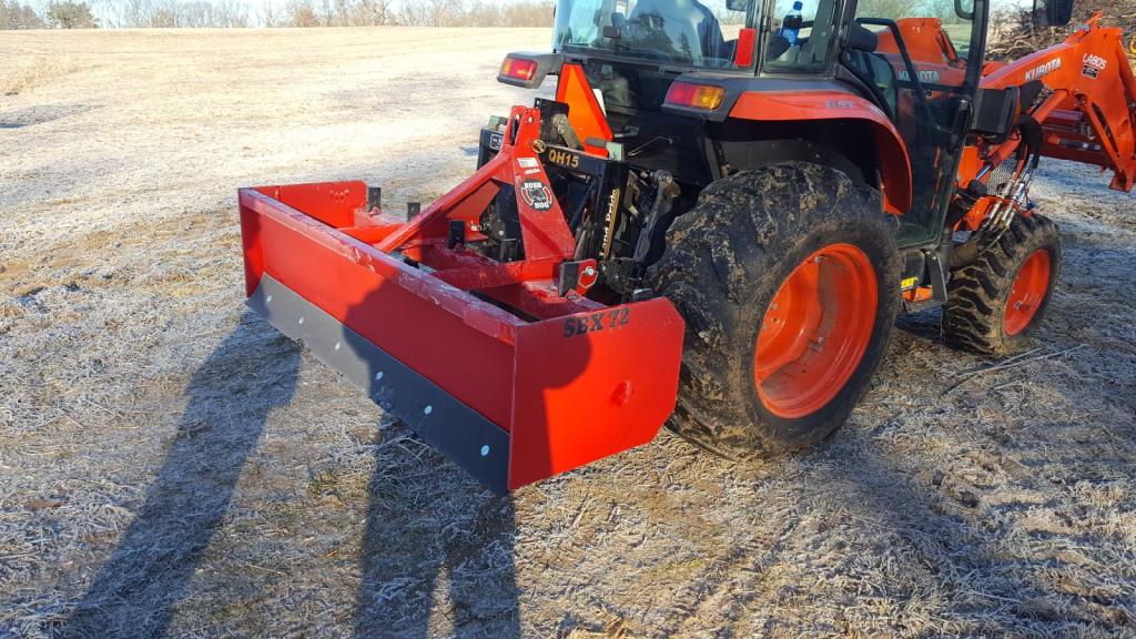

Mine are all generic, no name models, they work fine and dandy, I have one that's mounted to an SSQA plate and is used on my skid steer to use and move tractor implements around.
All of my implements have been made to be QH compatible, yes besides my PHD, but for the one time a year I need that, it's not that big of a deal to unhook the QH.
Geohorn, A hydraulic top link would cure your issue with the constant adjustment issue, and with a BOX blade makes it 100 times for efficient.
A QH is to some a blessing and to others a burden it up to you to decide. ;)

One major advantage that the Rural King model has is that it has an adjustable top hook, where the Land Pride QH20 has a fixed top hook.
It's not a big deal if you set all of your implements up to the same proper pin heights, I've done that with mine and I never have to move them around.
