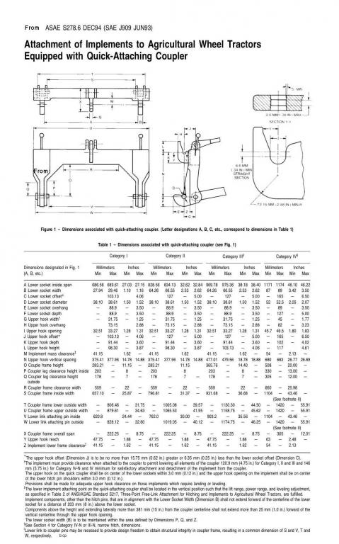

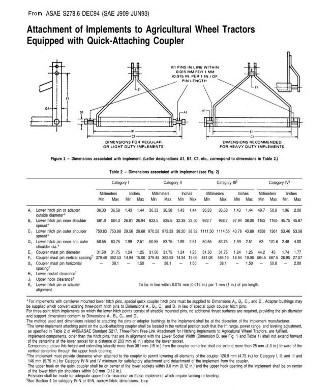

Any brand QH, if built to ASAE specs, will fit any same-category implement built to ASAE specs. No need to match brands.
Bruce
The problems arise when trying to attach older equipment or equipment that does not meet the specs. And not all new equipment adhere to the specs tightly enough to make them interchangeable. You need to "try on" each and every piece just to make sure it will fit.
