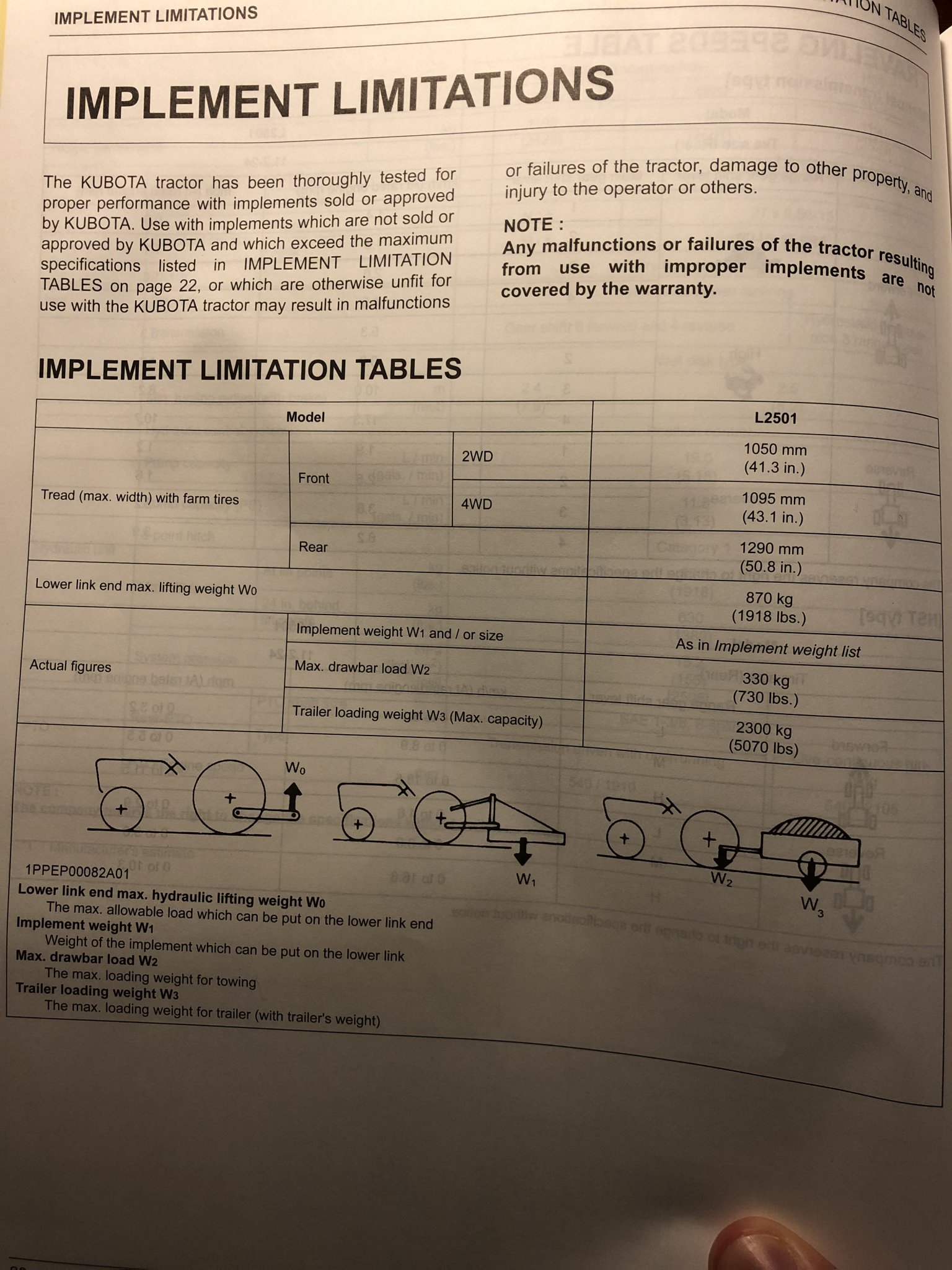

I am trying to decide between the QH05, QH10, and QH15 quick hitches from Landpride. For the L2501, it seems like watching the weight on the back is important.

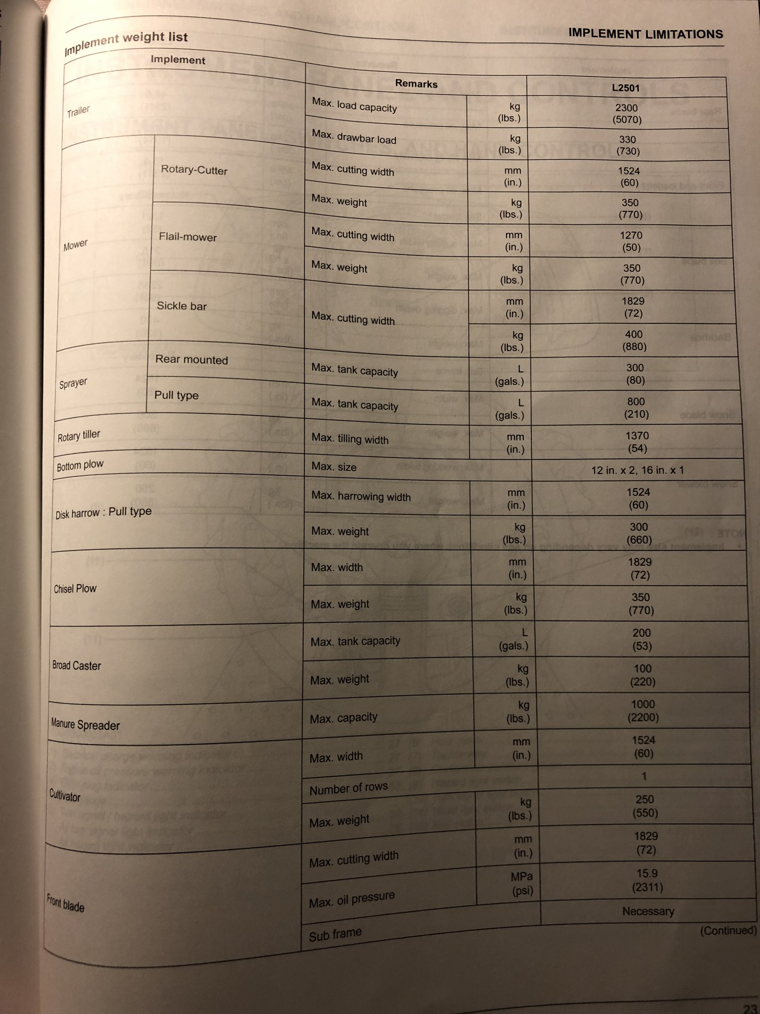

From the manual, the implement max weights are:
rotary-cutter = 770 lbs
disk harrow = 660 lbs
cultivator = 550 lbs
box blade = 694 lbs
The QH05 supports up to 700 lbs. and only weighs 37 lbs.
The QH10 supports up to 2,000 lbs. and weighs 67 lbs.
The QH15 looks like over-kill. But it has an adjustable top link. Is that really useful enough to justify it over the QH05?
An RCR1272 rotary cutter weighs 564 lbs. If I went up to an RCR1860 it weighs 599 lbs.
A DH1560 disc harrow is shown as compatible, but the weight is 628 lbs. If I add a QH10 or QH15 then its beyond the 3-pt rating.
I think I understand the trade offs, and I am thinking of just getting a QH05 to save some weight, which would let me run a slightly heavier rotary cutter and disc harrow without overloading the 3-pt.
Anyone got the QH05 and regret it? $268 is the current new price.
Anyone got the QH10 and regret it? $540 is the current new price.
The QH15 is only $557, so if I go for the QH10, it seems pointless to not upgrade. It only weighs 3 lbs more than the QH10.
I know there is a factory of safety in everything. What has anyone else experienced with different systems and weights, other than voiding the warranty...

Thank you for all the comments. I wanted to ask about the implement weight restriction, since I may not be looking at them correctly. From the comments above, the only thing that was looked at was the lift capacity 24" behind the link. What about the implement weight tables that are in the manual? Am I reading the capacity wrong by assuming that those capacities are what you should check for on the total "implement plus hitch" weight? See the attached screen shots from my manual. I only ask for clarification because the size and weight of disc harrow and rotary cutter I like the most is going to determine how heavy my quick hitch can be.

I may be wrong (it happened!) But I believe the tables Kubota puts in their manuals are based more on what the tractor can handle based on traction and balance (front to rear) than on hitch capacity. In the case of things like a box blade, they factor in how the full load in the box affects the ability of the tractor to pull it. Based on that they can say that a box of a certain size and weight will actually be able to be pulled. You can go bigger and heavier, but you will run out of either traction or horsepower with a full load. I believe this applies to the other implements as well, a combination of available power to run the implement and the weight plus the "working load" of the cutter or implement.
All that said, the quick hitch is a relatively insignificant part of the equation. Personally, I run a Harbor Freight quick hitch, with an aftermarket hook to gain a little clearance. Less than $125 total when I got the hitch on sale, and added the hook a couple years later. The adjustable top hook is important to me, as I have an implement that was not made for quick hitches, and the manufacturer explained why the top link needed to connect so high, in order to make the implement dump and clear its load. I converted it but kept the top link connection as high as possible . Works fine. Most of my other implements use the lowest setting, except the ballast box, which uses a middle setting. Changing the hook position takes all of ten seconds with the pins I use.

I may be wrong (it happened!) But I believe the tables Kubota puts in their manuals are based more on what the tractor can handle based on traction and balance (front to rear) than on hitch capacity...
Bushings or Quick hitch adapters are not expensive if you shop around. Plain bushings are only a couple dollars, and the pin on adapters used to be a bout $12 set at Northern Tool. Haven't priced them lately but there are a lot of source for them, so they can be had fairly cheaply.
Hey RBA50, that makes sense and helps explain the difference between the lift rating and implement weights. I won't worry so much about exceeding it. I have read of other people using bigger implements than the table (specifically with disc harrows).

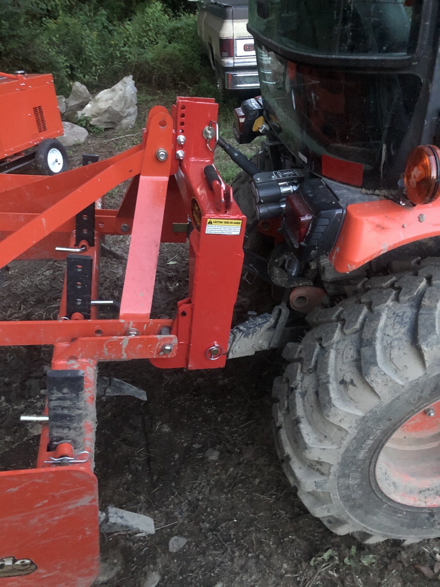

I got this one, looks a lot like some others I've seen pics of around here. Works good for me: tiller, scraper, road plane, no problems with any.
