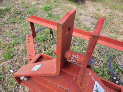

Two-part question:
Just picked up a quick hitch after reading about them around here - On the implement it fits, all's good. But there's something I hadn't considered before getting it: the TOP link.
Most of my implements have a top link with a bolt a few inches below, just close enough to block the QH top hook from getting under the pin.
I can see a few ways around this:
1. Position things first, then put the pin in. Only I still had a little trouble getting the hook in over the bolt, so I'm not sure that's going to work for all of them.
2. It looks like there is an adapter I can get that will let me link the parts, instead of a hook. (This seems to be the best long-term solution, and what I'll do - just read about that while posting this question)
3. What I'm wondering about: what about hooking it onto the bolt? Would that be safe, not only for operator but for the implement? Does that bolt have enough shear strength to work like this?
I was seriously considering option 3, pending responses here, until I read about that adapter. But I'm still curious if it would have worked.
Part 2:
Any trick to attaching the bushings? I didn't see anything in the manual. You can see one in the second pic - they have a pin that goes through the bushing and the link pin, and it's REALLY tight (for obvious reasons).

One thing that you can do is re-position either the top hook on the QH to allow you to hook up the implement or re-position the bolts on the implement to match the hook.

Looks like a piece of steel under top bolt. If you cut it out to use bottom bushing, add 2nd bolt/bushing to top hole.

In your first pic, if there is interference from the welded bar under the bolt, just move the bolt to the top hole, and install the poper bushings while you're at it. The bolts are fine for the top hook, not much load there.

Move the bolt. That's why most modern implements have two holes. One is for quick hitch, other one is for top link.
