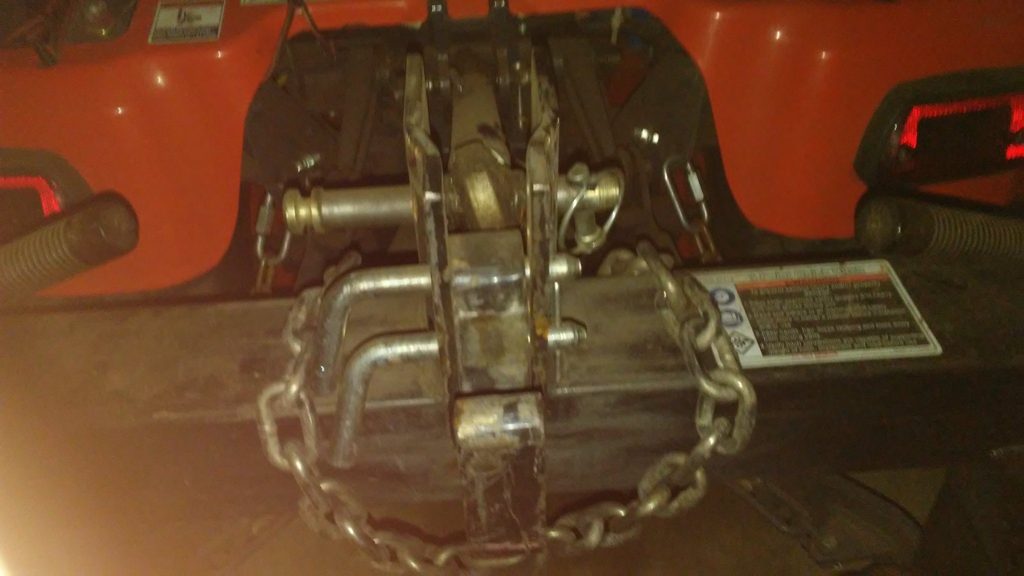

Another option which I have adopted, is to use pins that can easily be moved to adjust the hook as needed.
I just added these to my quick hitch hook today. 1/2 x 3in
