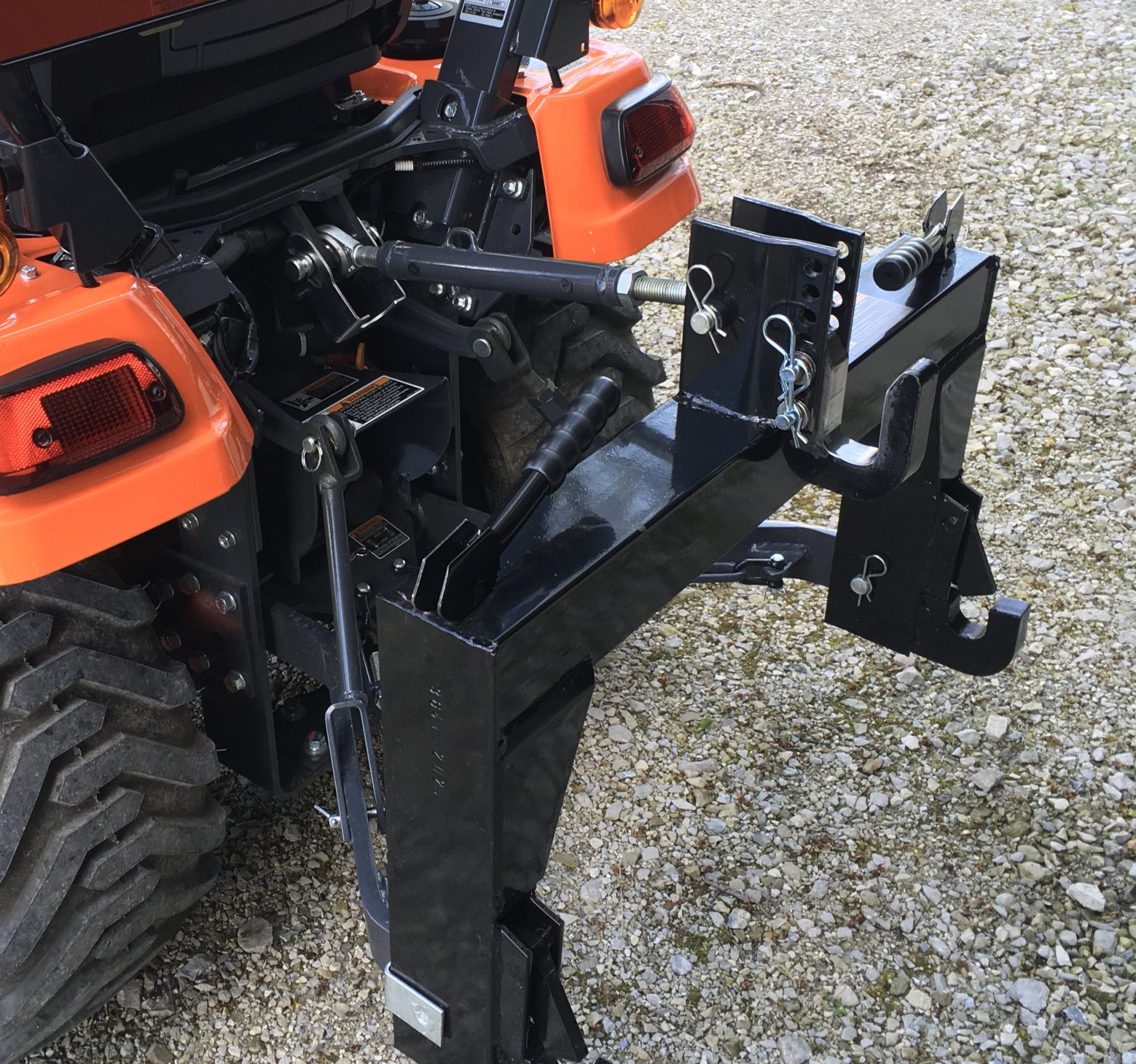

Yep that will hopefully fix the problem, I have the 1560 also. I'm not familiar with QH you have but I had to get the extended hook for mine, the original did not extend far enough out to keep the pins or bolts holding the hook from bumping the frame of the 1560 first. Hope this helps!
Tried to explain a little better!😔

Here is a couple pics, one of the original hook that I cut some of the meat off to allow extra room and it worked.. but I wasn't happy with it.
so I bought this one \/

Krush, that looks a lot like the HaulMaster version from Harbor Freight. I see that exact same QH with a lotta different brand names.
As for connecting:
1. As others said make sure the top hook is slightly farther back than the bottom hooks so that it hits the top of the 3PH first. Not by much, but enough that you have to push back on the BB a little to get the bottom hooks to seat.
2. If there's a slight side pitch to the blade, extend/retract the levelling link (on the RH side of the 3PH lift arms) to set it to the same grade as the blade, With the thick hooks on the bottom like the HaulMaster, it'll hang on most anything that touches them.
I see where some have modified just the top hook to open it up some. That may require some additional adjustment on the top link to set it for cutting, maybe not. Depends on the BB. What I did, though, is take the corners off the outsides of the bottom hooks so that they will guide themselves into the pockets on my BB1248 and under the pins without binding/catching on the sharp corners of the BB frame, and sharpen the 'point' of my top hook because being flat, it would just hang up on the BB. I also spray some spray grease in the bushings on the Cat II to Cat I bushings that are required for top and bottom hooks so that they can spin freely on the pins, and hopefully, it'll keep the pins from wearing some.
When disconnecting, I reach back and flip the latch levers up (with the BB fully raised) and just lower the BB where I want it. I find that propping the BB up with some cribbing so that it's tilted back slightly tends to make it work better. Generally, I just put 4x4 scraps under the BB at a 45 degree angle so they point at each other under the middle of the blades. I haven't yet, but want to put some kind of brackets on the BB to store my 'parking stands' on the BB.
When I'm connecting the BB, I first put the latch levers in the LOCK position (down). The linkage is spring loaded and will snap into place when you get a successful hook. Lower the top hook just below the top pin on the BB, back it in far enough to get the top hook under the top pin, then lift. The mods I made to the hooks let it slide right on without having to mess with the level much (if I didn't put something else on that did make me mess with it). I can't reach the levelling link from the seat, but I can reach the top link. With nothing but the QH on there, top link and levelling link are both pretty easy to turn. Can't say the same once I hook something up, though. I'm not good enough at it to do it in 19 seconds, but my procedures typically save me some mounting/dismounting the tractor. That's pretty important with a bad back.
I put some photos up somewhere on here that show the mods I made to the QH hooks. I'll go see if I can find them and drop a link to them. Strangely, there seems to be only ONE brand of QH that is completely Cat I and requires no bushings. Can't remember the name, but it's a bit pricey, and since my mods to my el cheapo HF/HaulMaster, it's as good as any I've seen, and better than some. $100 bucks at Harbor Freight. I did boo-boo, though, and bought a Cat I 3PH Drawbar/Hitch. Needless to say, putting it on is somewhat of a PITA because I have to take the QH off, since the QH is Cat I/II compatible (much wider). That's another purchase another time, or maybe I'll just get a bit of 2" box beam and try my hand at some more significant welding so I can just drop it on the QH to use it.
