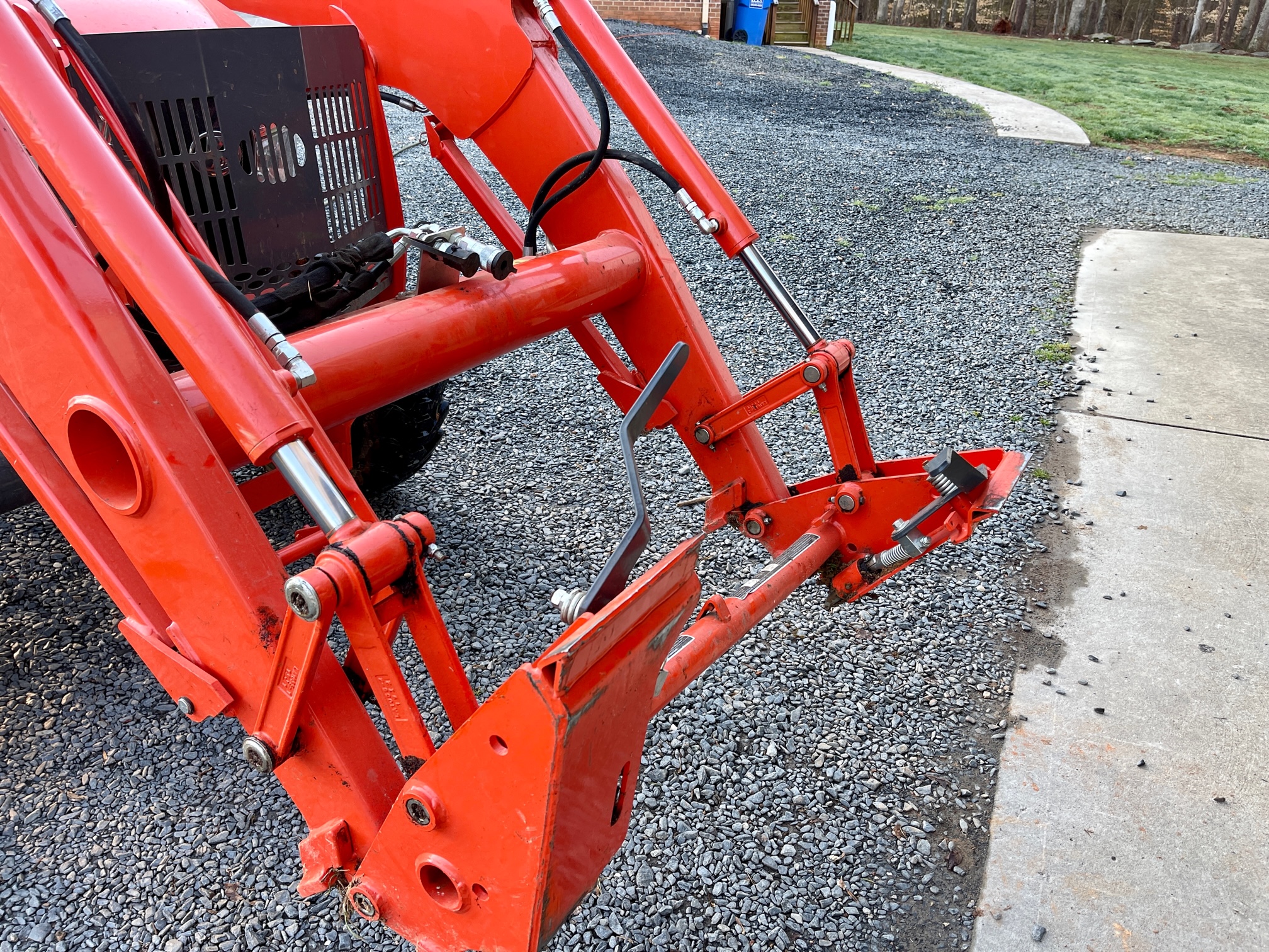

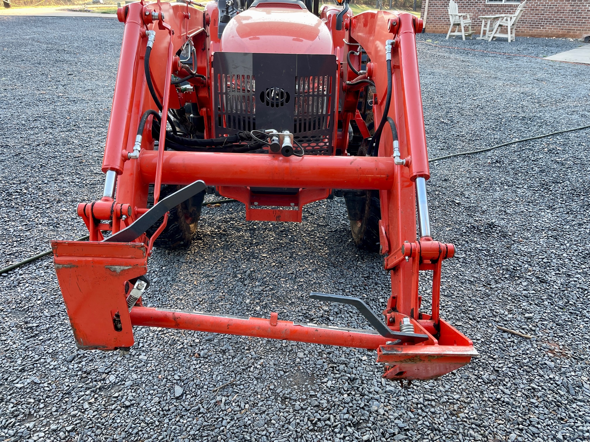

I was using my forks to move some small logs around to my wood splitter log pile. I had to push some branches etc. out of the way to get to the logs. Somehow the right side of the forks disconnected from the quick attach plate. This then placed all of the weight and leverage on the left side of the quick attach plate and twisted the plate. The loader was not damaged. The quick attach assembly is on nationwide back order but my dealer ordered a new quick attach frame and will transfer the parts needed to repair. I am glad I have KTAC insurance and a good dealer. In the future I will take the few extra minutes and use the grapple.

Are you sure it's bent? To me, it just looks like your loader cylinders are just out of time. Look at how much of the piston rod is visible on each side.
Put your left side SSQA up against something (like a tree) and try to put the loader into dump position. The right side should extend and catch up the the left side.
6,484
2,112
The “pipe“ between them is probably bent and twisted.
There are several threads that discuss repair by manipulating the parts or replacing the “pipe”
12,996
5,717
If you need to use it before new parts come in..., find where the bend is, cut the pipe, insert 12" sleeve, 'reset' the frame(both cylinders same and mtgs aligned, weld tube back together, should be 'good to go'.

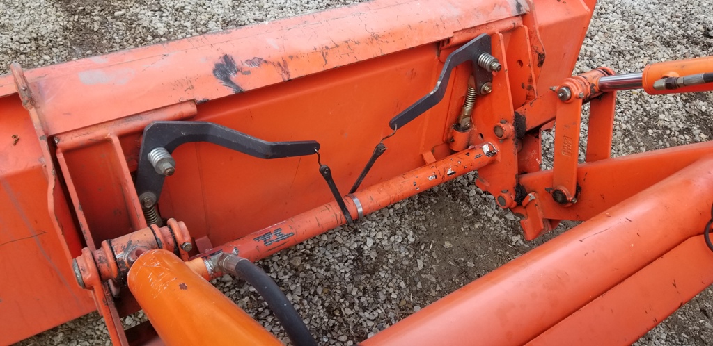

Here's a simple, inexpensive solution to prevent this from happening.
Drill a 1/4" hole near the end of each lever. Insert an appropriate length bungee cord in one hole, run it under the tubing you twisted and hook the other end in the hole in the opposite lever!
If you use a grapple one for sure needs to be aware of the locking pins position. Check at time on moving levers down, then double check by raising loader and actually seeing the pins in position.
10,095
6,917
'Cat posted a similar picture before. Simple, easy and inexpensive.
If I ever have a SSQA, I noted a while ago that the first modification would be that one. (y) :cool:
