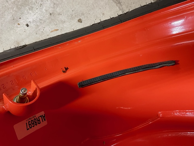

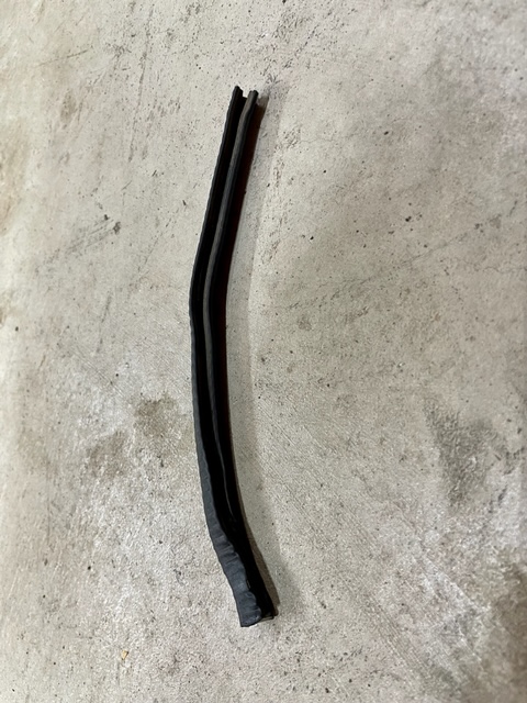

3) Minor misc. question: Does anyone know where this protective rubber trim guard goes? Fell down below hood hinge on right (oil fill) side as I was opening it? Looked for longer than I care to admit with good lighting and can't figure out where it belongs. It goes over an edge and has a distinctive shape. Took a second pic on the back rim by the stem for size reference.

Can't answer your oil questions. I believe the trim goes on the very front bottom edge of the hood.

looks like what they put on the hood edge as stated above. Mine wouldn’t leave the hood latch because it was out of position. Pinched it tight and reinstalled, if it happens again I will use weatherstrip adhesive.

Can't answer the engine oil capacity. That little bit of super udt you added to the front axle shouldn't matter. When you service it next time, I'd just stick with the correct weight gear oil. I had issues with using UDT in my old BX. Switched to gear oil and it really slowed down the seal leakage.
As others have said, that rubber strip looks like it may have come from the front edge of the hood. It just looks a little short. Perhaps it came from underneath the hood/up near the dash/cowl? I had the same thing happen to my hood gasket on the B2650. I wound up gluing it to the hood.

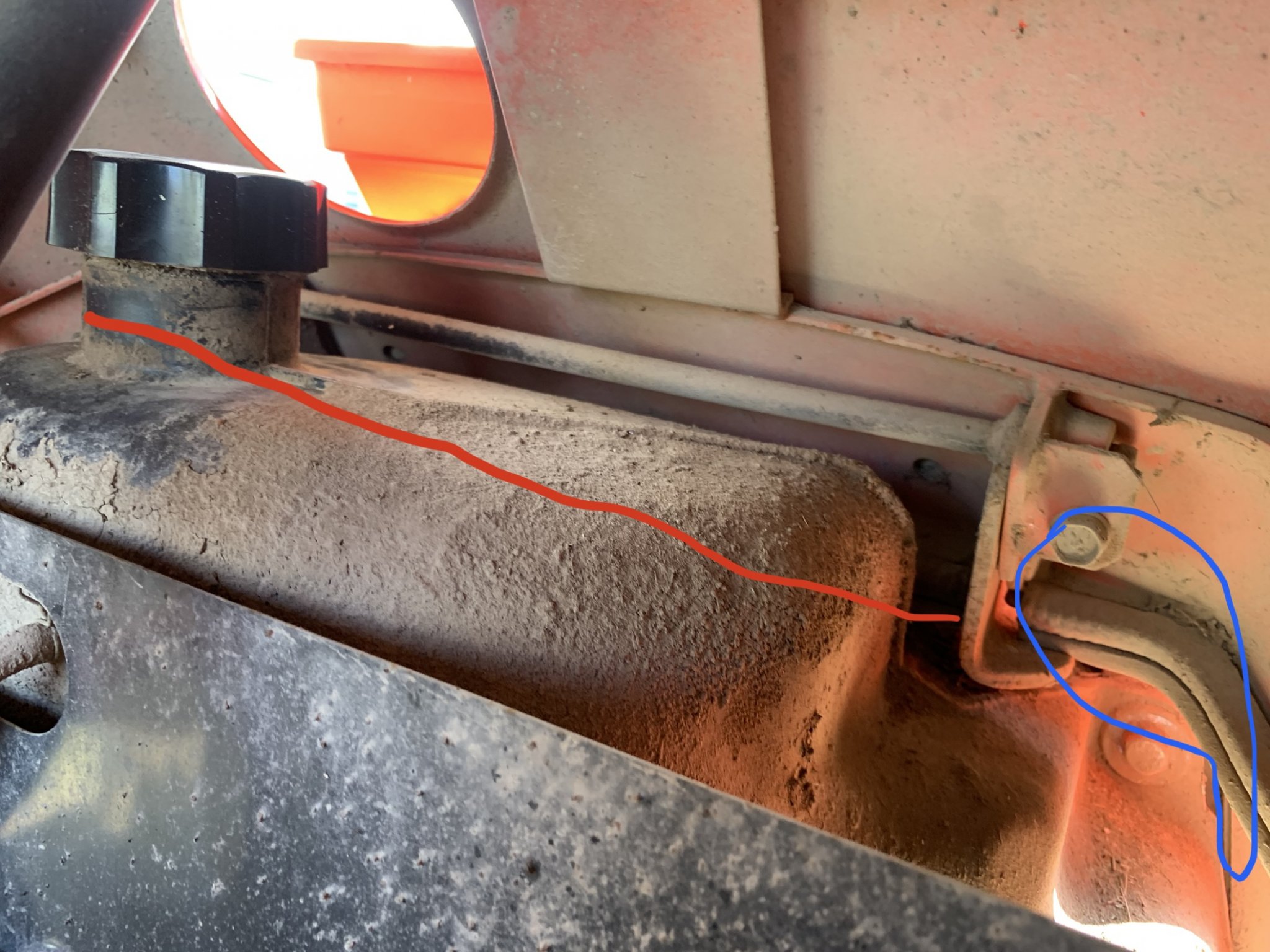

trim, was it by the hinge, above the fuel tank?
It looks like it may be this one (red line, I can’t get a pic of it)
looks like the one circled in blue but between the hinge. Roughly 9-9 1/2 inches long.

Thanks for the info on the trim piece - will check again tomorrow.
