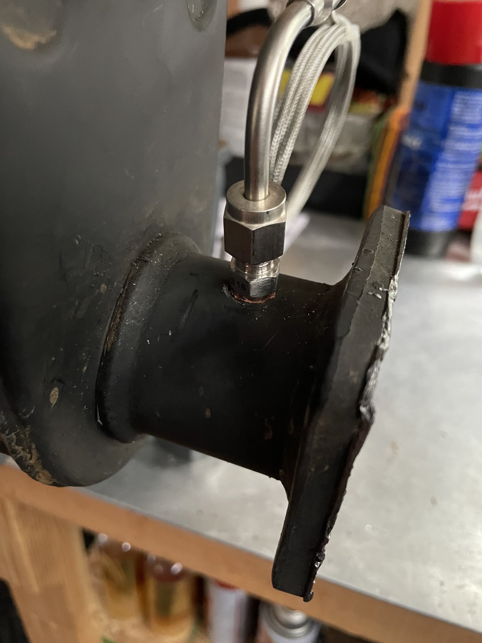

Assuming someone doesn’t wish to drill into the exhaust manifold, I believe the best compromise for the probe location is in the muffler inlet pipe;
