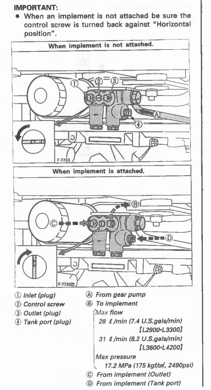

Dave, attached is the hydraulic port hook up from the operators manual (available on kubota books). If I understand his explanation of how he hooked it up, all three lines appear to be wrong at this port.

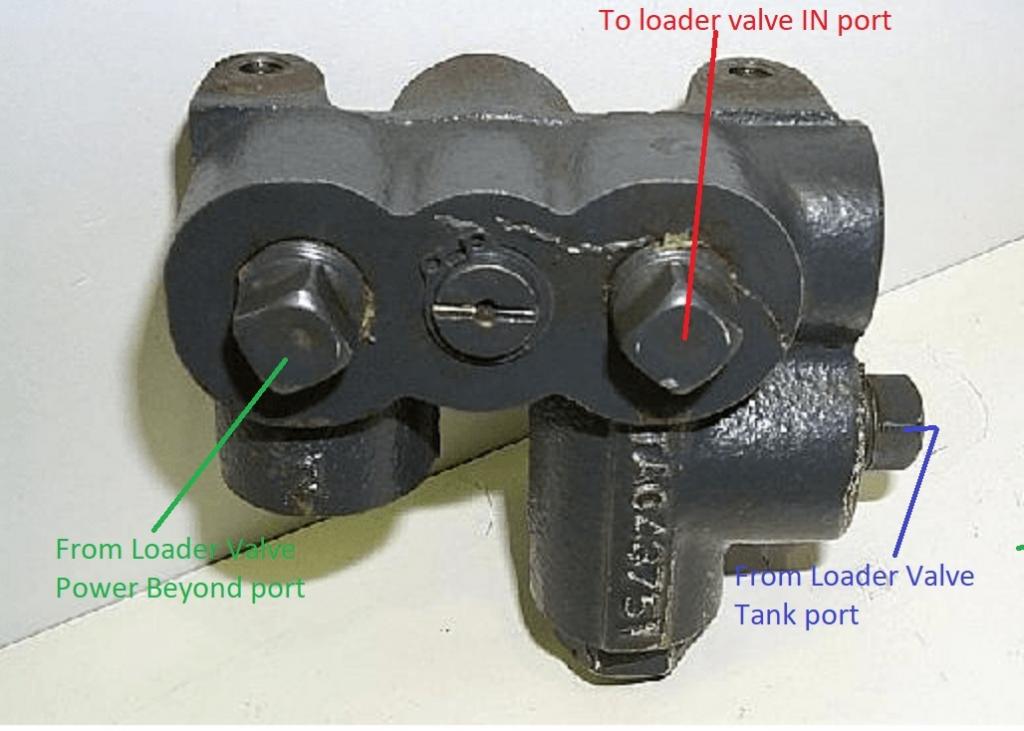

Please look at the initial photo with my added markings.
I am looking for feedback on how I read the manual's instructions.
The owner's photo is misleading as the center screw is set horizontal but he says he has it turned vertical.
He has hoses in the wrong places as you have said.

I have the same valve on mine. I'll have a look tomorrow.
Did you turn the slotted screw in the centre? Mine is 45 degrees one way with loader connected and 45 degrees the other way when the loader is off the tractor

Dave, I agree with your marked up pic according to the instructions I posted.
Dave
