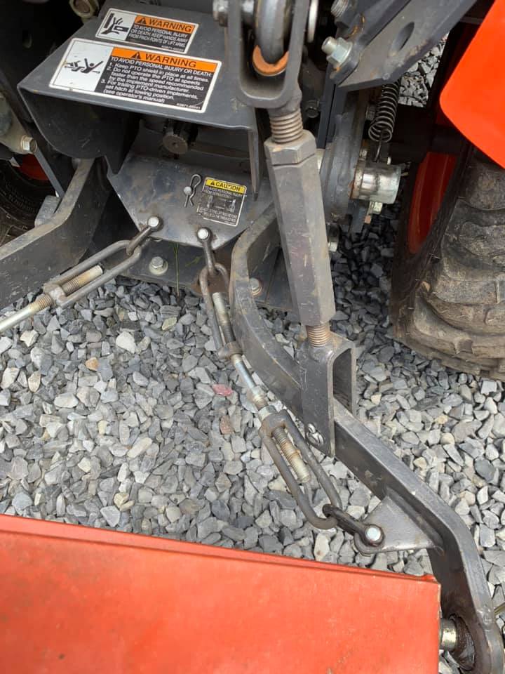

Don't ignore the lift arms. Pushing barkwards may not hurt the implement, but the arms are designed for pulling, not pushing. I've had more than one BX owner complain that their stabilizers wouldn't attach, and send me a photo. The lift arms were so bent, the two holes weren't able to be connected by a straight line.
My B2650 3-point system with solid adjustable anti-sway bars is built a lot heavier than that BX.
I build a lot of replacement telescoping stabilizers for the Kubota B series tractors. They are not that substantial. The flat plate is narrow and thin, and bends pretty easily under compression.
The dimensions of your lift arms are the same as on a BX- same width and height (2 1/2"). You have to get into the MX series before getting bigger lift arms (3"). The only difference are the bends in the arms, and possibly the length. The base shaft is the same- 7/8" diameter. Additionally, both the BX series and the B series use 3/8" clevis pins to attach the stabilizers. So, the only strength difference between the BX series and your B2650 is possibly the bends in the lift arms.
The 3 point hitch is designed for pulling. In many cases, pushing is fine, but that is consequential. It was not designed to push, so damage is possible. I would summize that the majority of 3 point hitch damage comes from pushing, not pulling.
Well, the stabilizers on my B2650 are guaranteed stronger by far than the turnbuckles on that BX, and actually DO handle quite a lot of compression stress that stops the kind of sideways twisting that the OP photo shows. It's also not something I use it for very often, but that reverse scraper blade on my boxblade has some very helpful uses for me. So not afraid to use it.
But I agree, the 3-point will handle WAY more stress and loads when pulling that boxblade vs pushing. I've caught frozen stumps while dragging the BB along at a walking pace and it stopped the tractor instantly. BANG. The seat belt grabbed my hips hard. I doubt those lower arms and stabilizers could handle that kind of sudden compression without something giving, but pulling the BB the whole system took the shock without issue.

Thanks for all the replies, I've learned some good stuff. I have to confess I was focused on the implement and not the tractor. I was surprised to see the picture of the bent lift arms! It would seem that if you have a QH in the mix that would help strengthen the whole 3-point system? (As an aside, I've been using the Pat's QH and it feels a bit iffy to me. I think if I added a strong bar to sort of lock in the distance between the lift arms, I'd feel better about it.)
