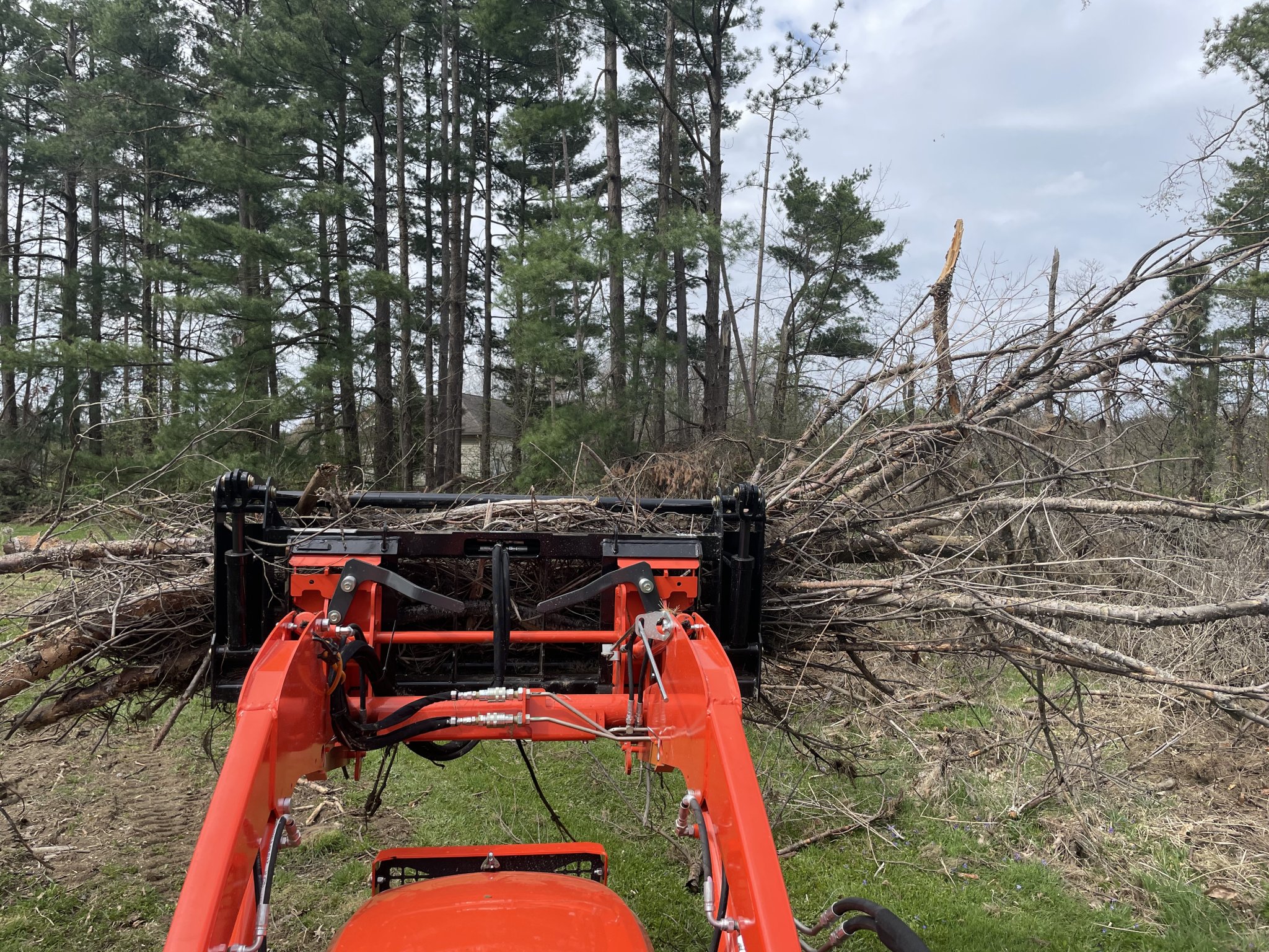

Here’s mine with the factory Kubota kit on an LX2610. I use a bungee to take up the hose slack from the grapple. Zero issues.

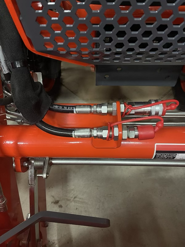

Another grapple connector picture! B2601, Kubota 3rd function dealer installed:

Your valve 3FV kit looks like the same Summit kit I put on my LX2610SU. I like the hoses turned that way because it doesn't stress the hoses on the grapple during operation. I bought a grapple made for LS tractors, which came with 1/4" male connectors on both hoses. I had to step them up to the 1/2" QC's, so I just bought 1 each QC with 1/2" NPT thread and two 1/2" to 1/4" reducer bushings. Bingo, problem solved.

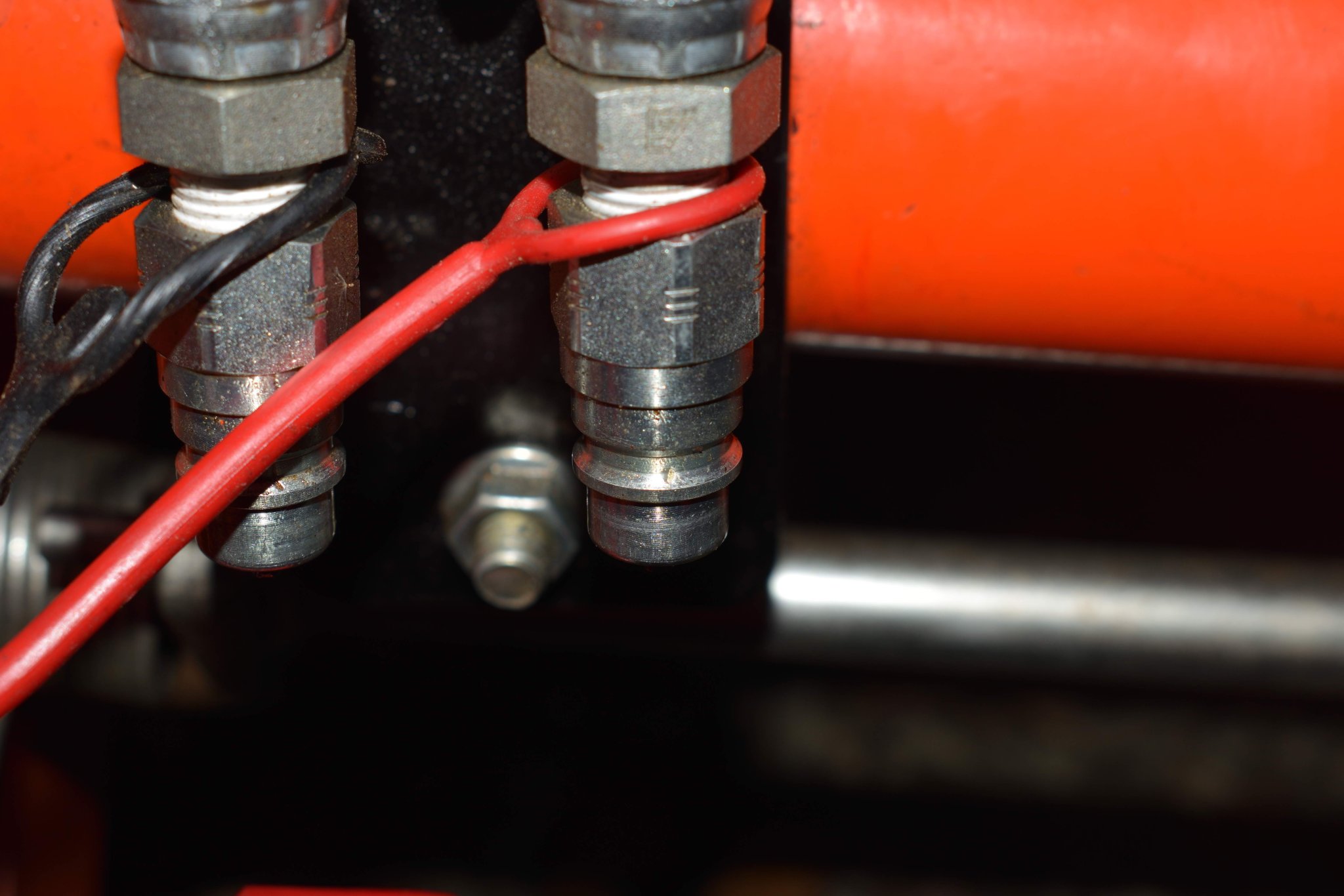

my B has two male connectors I think the males with the covers are less likely to get mud or dirt in them. the females tend to get more dirt in them and the covers do not seem to stay on as well

Interesting. On my B the covers on the male always come off, the covers on the female are really solid because they click in. The covers on the male seem to have stretched so they have no purchase. On the upside the males are pretty easy to wipe clean, whereas dirt in the female is pretty hard to get out.
