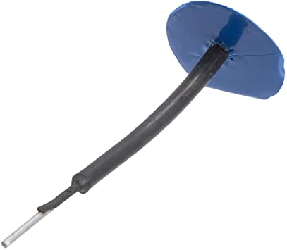

One place that does truck and industrial tires said to patch it along with the tube due to the slit. Any thoughts?
If it were mine I would patch plug it and be done, no tube 🤷‍♂️

So, I don't expect typical hazards that will cause repeat punctures (this was pretty thickheaded on my part), I ended up having a truck/industrial tire place use a HD patch.
It was not a plug/patch like above - those look great. I will have to source some of those for my "kit" and will keep a tube on hand as well & also know foam is a good option if this becomes a habit! :rolleyes:
