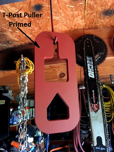

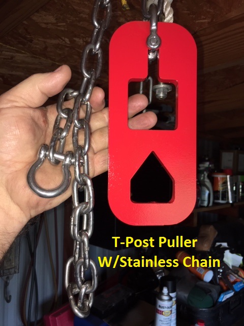

I'm not a person too much attracted to 'gadgets' but I've got a bunch of T-Posts I need to pull (by myself).
Normally (with help) I just use a chain, throw a couple of half hitches on the post and lift it out with the front loader.
But I've been looking at these T-Post pulling 'Plates' that can be used with either a chain or farm jack.
So I purchased one (a good steel one, not cast). It came as raw steel...so I primed and painted it (just because I don't like rust, I am retired and have the time). Had a short piece of Stainless chain laying around....so attached that to it.
Might have a chance this coming weekend to see if they are worth a hoot. But certainly looks like a person can just throw it on the T-post and lift the bucket to extract the post. We will see.
Anyone used of these before?

I’ve got the same with a few feet of 5/16” chain. No D-rings. Use the hook in the center of my bucket on my B2650 and it pulls the posts at an idle.
it’s really fast,but I think that the way you have it rigged will make it tougher to use. Its intent is to drop the deal over the post and then dangle the chain through the slot. After extraction, the chain comes out fast. My kiddo drives to the next post as I’m dropping the plate over it. She lowers the bucket and just touches the post. I drop chain through slot, and we repeat.

Yes, MUCH easier to have a 'driver' and a person on the ground to hook up to the posts. My Brother and I do it that way when he is here to help. He drives the tractor and I just quickly wrap the chain around the post.
But I have a bunch of posts I need to pull right away....so won't have any help this time. My thinking (maybe in error) is that I can leave the plate permanently attached to the chain and run the chain through one of the hooks on the bucket.
Then just drive up to each post, place the plate down over the post and while still on the ground....lift the bucket to pull the post. I can then slip the plate off the post, mount the tractor and move forward to the next post. The plate 'should' grab one of the nubs on the T-post once it achieves a position of about 45°.
I've pulled T-posts by myself before just wrapping the loose end of a chain around it (couple of half hitches). Occasionally the chain will slide a bit before taking a 'bite' but not often. I expect the same thing from the plate...but we will see.
